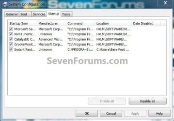

Hello BruceUK, welcome to Seven Forums!
Type "msconfig" without the quotes into the start menu / search box to open the config utility, under the "startup" tab see if you can identify any entry matching "HP Wireless Assistant" and see if disabling it at startup will sort the issue.
Be sure to post back with the outcome.

Hiya,
Thanks very much for your response. Yes there was an entry in the Startup list for the HP Wireless Assistant, which I have now disabled. The executable concerned is HPWAMain.exe. I restarted the computer, it booted up OK and all seems well. Of course I won't really know whether this has solved the problem until I've used the computer for at least a week or two without the problem recurring - but at least the change doesn't appear to have done any harm, so fingers crossed! ;)
Thanks again for your help.

If that does not seem to fix the issue, please check your "system" event log for further details.

Hello again BruceUK.
Yes please do come back to let us know how it sorts out.
Have a look at "Option Two" in the tutorial that your issue prompted me to create, at the link below.
http://www.sevenforums.com/crashes-debugging/70248-troubleshooting-msconfig.html

Hello Bruce.
You could use "Option One" in the tutorial to see if you could pin down which program is causing the issue, though as it only happens intermittently that may be an involved process.
Using "Programs & Features" in the Control Panel will remove the app all together where if you wanted to remove the entry as a test using the reg edit you could create a http://www.sevenforums.com/tutorials/697-system-restore-point-create.html before you do the regedit that you could use to add the reg entry back later if you wanted to.
It's all up to what you want to do, I'm not sure why that didn't solve it, I assumed it had.
