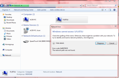

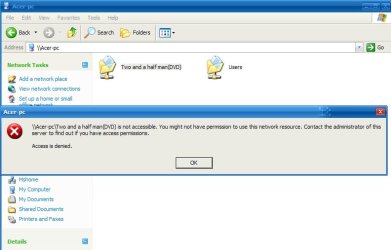

I have Windows Seven 7600 and i'm trying to share files with a XP SP2 machine!
Problems:
-XP machine can see Seven machine but can't access shared folders!

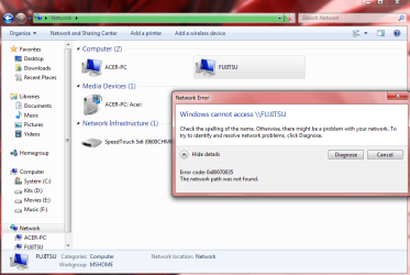

-Seven machine can see XP machine but when i'm tryng to see shared folders it gives me an error(see on screenshot)

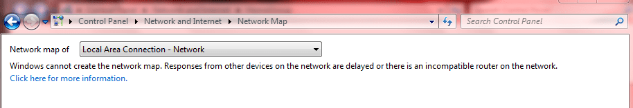

-Network map doesn't work(see screenshot)

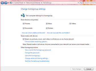

-Both machines have same workgroup MSHOME but when i go to homegroup it says there is no people in the homegroup!(see on screenshots)

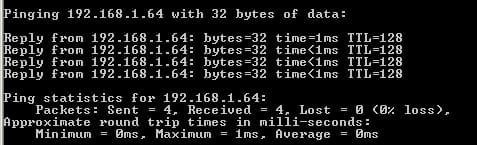

visy, is it a workgroup, or a homegroup called "workgroup"?. Is the xp in a workgroup, and the win 7 in a homegroup?
can you ping from xp>win 7, and win 7>xp

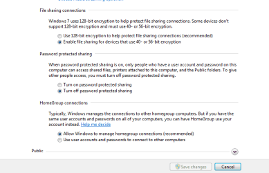

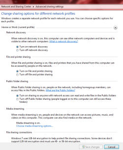

I was just setting this up the other day so I could share network files between my XP machines and my Win7 machines.
I had to run the network setup wizard in XP first, then click the allow sharing files option when it gets to the end.
For Win7, you need to make sure that everything is set up to share files on both the home network and also the public network. You need to click on the public arrow at the bottom of the page to enable public sharing. Looks like this.

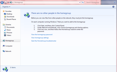

No,both have same Workgroup :MSHOME,when i go on Windows Seven to homegroup it says there is no other people in the homegroup!
I modified security options so now i can acces files of Seven machine but Seven machine still can't access Xp files!
First screenshot it's XP pinging result,second is Seven pinging result!
Some way i Seven machine can see XP machine but still can't access it!(see screenshot)

Thats because in order to use homegroups you need to share libraries.
The easy way to do this is outlined in my first post. I've been sharing with my XP machine and Win7 since day one without problems.

Im thinking you have a workgroup called mshome (on xp) and a homegroup called mshome ( on win 7). They are different. you can change the homegroup to a workgroup. open hetwork and sharing and either create a new connection using the workplace instead of homegroup or click on your existing homegroup and change it to workplace.

I switched to Work network and see on screenshot what says on homegroup!
Are both computers in the same workgroup (look on the xp box)?
Ken
Watch the screenshots!

Thanks for your help but still don't work properly!
I disabled KIS on seven and on XP i disabled Avira firewall!
I can access Seven machine files from Xp machine,when I try from Seven machine i can see now XP machine but it gives me error when i try to access files,watch the screenshot!
Like zigzag says:

Hey visy
that same error code was cured in the vista64 forums here error 0x80070035 - Vista Forums
It is a permissions error. If all else fails set all the permissions back to default and try it again

I fixed the problem thanks to squonksc,you're amazing!
The problem was TCP/IP NetBIOS Helper service,it was disabled,just enable that service on both machines and everything will work fine!
