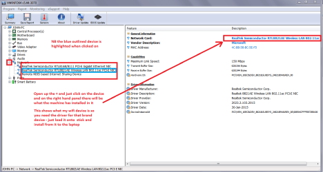

Open each small square with + in it on the section the components are in and then click on the individual component/s (it will highlight in blue) - in the right hand side will appear all sorts of details including brands speeds and other essential info that particular device. See pic for example.
Use PART B: and if necessary run it from a stick my pic shows what you are looking for

Ok Clark now I linked that stuff purely so that you could find the brand of network adaptors in that machine to be able to get the manufacturers driver updates as I was going to go on and suggest you update the LAN and WLAN drivers for your machine - even though you have done the Dell site one for the wifi.
I do this for any of my machines or fixes I am on because the Windows driver update/check feature is not in my mind terribly good at updating any software such as drivers. As it happens this is a pic of my laptop's network adaptors so it would be the same type of readout for your machine. The laptop is an Asus model and I still like to find out just exactly what is inside the machine even though Asus support has links for a driver, and you can see from my pic the laptop has Realtek adaptors installed and having found the model of adaptor I can go to the Realtek site and get it from there if I needed to.
Anyway it is your choice as to what to do but at least you would see if the machine has an Ethernet adaptor installed, and know what brand and model it is because I cannot believe that Dell has not put an adaptor for Ethernet in that machine unless the wifi one covers both but form mu experience so far that is very odd.
