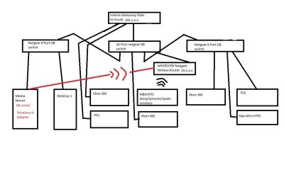

I have a pretty elaborate home network consisting of a wired gigabit ethernet primary network and a wireless-N wireless network. everything i have been able to get functioning flawlessly excluding getting the windows shares and ps3 media server i run from a wired windows 7 64-bit server to share across the wireless portion of my network. i attempted to fix this issue by purchasing a 2nd adapter for said server so that it would have both a wired and wireless connection and be able to share across both the 192.x.x.x subnet(which already works) and the 10.x.x.x subnet(which hasnt been. I now have the 2nd adapter setup without a gateway as to not confuse internet traffic going FROM said server so it will use the primary wired gigabit adapter instead of wireless. I am able to ping from the wireless side of the network back to the servers assigned wireless IP but for some reason still cannot see the shares, i have been unable to find any adapter specific share settings in win7 thus far and am wondering if i am missing something. any help is appreciated. Thanks. network topography attached.....

The current networks are at 255.255.255.0 subnet with one network on 192.168.1.X and the other at 192.168.2.X.
The verizon router is providing broadband connection and has public IP and devices on both networks can be reached aross both via IP but for media server or anything else they dont exist to eachother. I am attaching an image of the configuration.
I did change both subnets to 255.255.0.0 as you suggested but the only option I see on verizon actiontec MI424WR other then dhcp is called dhcp relay. Is that what I want? or should I change setting on the Belkin since that is on the side of the media server?

Well the two routers (provided one) and my own are providing ip's in different subnets. If I remote one router then all ip's get provided by other router since the nimh device merely extends the right side of my network to another physical location.The main reason I am using the N+ Router is for wireless and the few ports to add a tv and blu-ray to the network parallel to the cisco switch.
From trying out the 255.255.0.0 subnet on all devices the routers no longer communicate with eachother at all and the internet conection was lost also. I have been reading that I need multicasting across the different subnets between the two routers but does that mean both need to multicast or can i just purchase 1 that supports multicasting? The VPN idea would probably work even though it seems crazy since the nimh already extends the network across. You are also right where I dont think my routers support that anyway...
You can attempt a crossover from router port to router port but you're still going to be slamming your head against this mutli dhcp service brick wall. You're subnets will have to be the same and your DG will have to be the same for the sharing you're requesting.

Yes I think Ill just remove my router and run from the nimh to the switch and have router at the end out of the switch for wireless seperate from other devices. Are there any routers or other devices you can think of that may do the multicasting for shares across subnets or present another solution in case I can invest in the hardware in the future? Thanks again.
Layer3 devices can handle that setup. I say devices because you can have 1 dhcp service multiple subnets... at that point you don't need to route the traffic, a layer3 switch will do the same thing.
