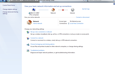

Hello everyone, I have a brand spanking new Gateway DX-4840 desktop computer. It has an Intel core i5 cpu, 650 @ 3.2Ghz, 6GB ram, 64 bit OS. It still has the 'new computer smell", however, Window 7 is not making it easy to remain. :sarc:
No apps have been installed except what came on the PC.
DHCP is enabled and I am recieveing an IP address, I can view my network of XP machines fine, I can connect to the company file server and do everything that I should be able to do. I can ping internal computers with no issue.
This computer is in the workgroup as everyone else.
I have tried to uninstall/delete network adaptor/restart and let windows reinstall the software and no success.
This comes down to ZERO internet access.
Please help.
I appreciate all replies.
Steve
BTW, wireless is NOT an option. Only hardwire is. The LAN wire I am using connects all computers flawlessly EXCEPT the Windows 7 desktop.

Hello there, your problem may be the fact that your TCP/IP stacks and Winsock configurations are somehow damaged.
To solve this, follow the next steps:
1) go to start, type "cmd" in the search bar (without quotes), right click it and "run as administrator".
2) type this: "ipconfig /release" (w/o quotes) and press enter.
3) now type: "ipconfig /flushdns" (w/o quotes) and press enter.
4) now: "ipconfig /renew" and press enter.
If that doesn't solve it, do the following
1) type on the CMD window: "netsh winsock reset catalog" and press enter.
2) after done, type: "netsh int ip reset reset.log" and press enter.
Reboot and check if everything works!
And of course, report back... please :)
Windows
Windows
PUNK!! Thank you!!
First off, thank you to everyone for your help. PUNK is the winner in this case and provided the solution I needed in this case. Thank you again everyone!!
