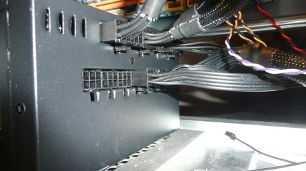

As Dwarf pointed out, the plug-ins on that Corsair PS are very confusing at best.

On the 8 pin ATX/EPS connector there is usually a tab and groove that allows you to detach or combine the two 4-pin connectors. You slide them up and down against each other to connect/disconnect. You should have one 8-pin plug to work with. You normally do not plug each 4-pin plug individually. If you do, the tab may spread the plugs far enough apart that it will not make good contact.

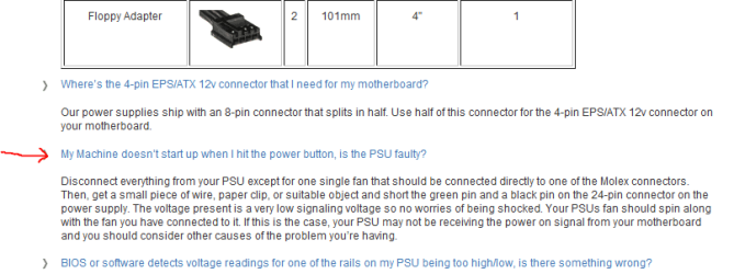

The Corsair website has this diagnostic (image below) to test the supply for proper startup logic. This will let you know if the issue is with the case switch or connections.

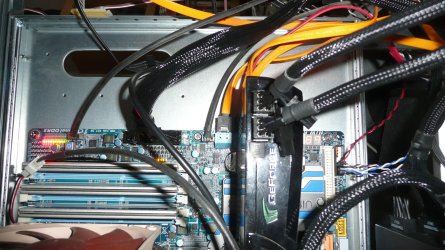

I'll attach a picture of what the LEDs on the mobo look like. They look the same with or without other items plugged into the psu.
I've looked at the Corsair site and performed the paper clip test on the psu. This indicates that the psu is good.

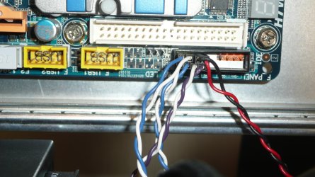

I am still concerned about the tiny front panel headers. When I built the machine it wouldn't post and it was a problem with the way these were connected. At the moment I have a power button that works plus 1 blue LAD on the top panel. The rest switch doesn't work but it never did before.
This is what the LEDs on the mobo look like with or without everything else disconnected. I'll also post a pic of my socket arrangement with all plugs in plus the front panel headers that were the problem before.

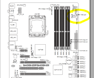

Just a suggestion if you haven't already.
Disconnect the front panel switches and use the on board.
Shown in Snip.
Power and reset circled in yellow.
That would eliminate the front panel switches temporarily.

Think I already tried that. Without those headers in it won't post at all. That's the problem I had when I first built it, I left them out deliberately to eliminate any issues and they were the issue.

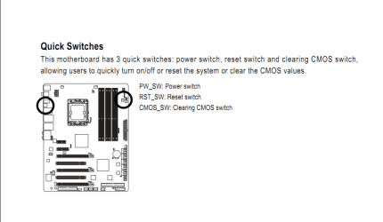

It doesn't give any info on operation.
It just shows where they are located. :(

No I mean the little front panel headers. They go into a box on the bottom right of the mobo. There's a picture of them in one of my earlier posts.
