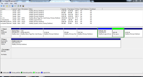

I've created some problems I can't seem to get myself out of. After installing Windows 7 to new SSD, ran it for while and recendlty installed Linux Mint Mate in a Dual Boot situation.
1. When doing so I created a 10GB Partition for OP Over Provisioning at the End of Drive using gparted (Maybe should have used Windows 7 for this). One thing I noticed was that gaparted would only allow an "Un-allocated" Partition to be a "Primary Partition".
2. I then created a small 2GB NTFS Partition to the Left of that still at the end of Drive. I was told to do this so that the SSD would recognize the Linux install.
3. I then installed Linux and it all seems to work, except for my "Over Provisioning" Partition is not being recognized for some reason. I tried to fix this in Samsung Magician to no avail.
a. Is it possible that I created more than Four Primary Partitions and it has got my system confused? I also see that two Partitions are surrounded by a Green Boarder. I'll try to post a screenshot here but forget the best way to do it, Attachment, Embedded etc. I thought "System Reserve" and "C Drive" needed to be "Primary" also?

The DM screen print in post #8 does not show all the info.
You should at least resize the Status column to display all info.
Here are instructions for posting a maximized/resized DM screen print to show all info:
http://www.sevenforums.com/tutorials/274797-disk-management-post-screen-capture-image.html
From what i can see in Post #8 it looks like you do have more than 4 primary partitions, and more :confused: :shock:
From what i know OverProvisoning uses Unallocated space, not a partition.
Others can correct me, but i don't think your 10 GB partition at the end of the drive does what you want.
The drive where Windows is installed does not need to be Primary, it can be Logical.
The drive that has the bootloader does need to be Primary.
In your case the bootloader is on the System Reserved partition - that MUST be Primary.
In your case Windows is installed on C -that CAN be Logical.
In DM the System, Active partition shows where the bootloader is - it MUST be Primary.
In DM the Boot partition shows where Windows is installed, it CAN be Logical.

Let me give this another go!

Can we assume Linux is on Purple32gb disk1 ?
And how did you end up with 2 disks using 1 ssd ?
No Linux is on SSD with W7, that is a USB Storage device.
