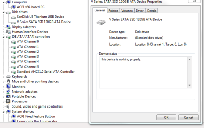

hi thanks again for your help
however I am unsure of the exact sata location of the ssd but is installed in only slot/bay for storage (mini pc). crystal disk mark shows msahci as ok so assumed was running in ahci ?

NVIDIA's MCP7A chipset has only SATA II (3.0 G/s) so you'll never reach the 6.0 G/s. DailyTech - NVIDIA MCP7A Chipset Details Revealed
But you are working on as SATA I, and it's probably because on BIOS your drive is set to IDE mode.
To install under SATA you will need to set to SATA (and may have to load the NVIDIA's MCP7A drivers during win 7 installation)

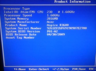

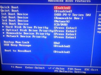

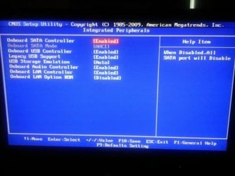

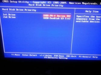

Hi sorry abot that here are some pics of bios took pics of all that may be required just in case

The pictures helped a lot.
On picture 4 I see AHCI port 0 = not detected.
Can you attach the SSD to AHCI port 0 instead of AHCI port 1?
Edit. Just seen a Youtube video and saw how it is assembled. Only one slot.

Hi
Oh great, yes this is as i said seemed to be in ahci?
As for changing ports the machine has 1 drive bay ? I am unsure if it can be done on my pc i have searched alot on my pc and ssds ahci but no joy just how to physically install no bios help etc

Sad to say, but it seems there is nothing you can do.
- You SSD is SATA 600
- The chipset is SATA 300
Don't know why it works as SATA 150.
Is there a BIOS update to your device?
