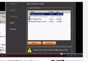

How to Install/Update ATI/AMD Graphics Drivers - YouTube
watching this, my ATI install manager never shows the ATI driver as it does in this guys list.
here is his install, mine does not list the driver or the ccc as his shows.
All I get is the cim

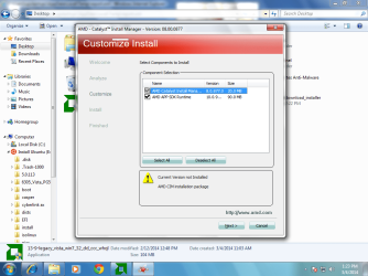

here is screen showing no driver in the list for me in custom install.
I also downloaded the AMD cleaner to clear out all amd stuff first.
So of course not working because AMD installer does not install the driver or the CCC.
