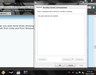

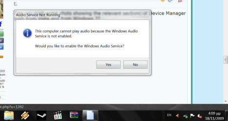

Hey guys im new to this forum .I have a problem i dont have any sound.When i click on the volume icon at the bottom of my screen and go to playback it says ''No audio devices are installed''When i open the sound options there are no speakers.

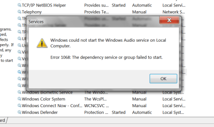

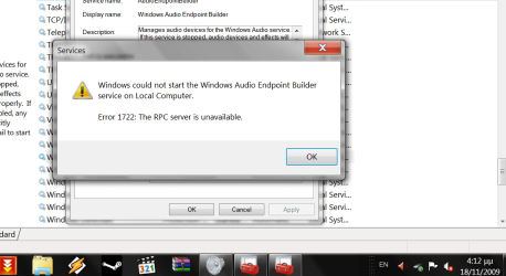

When i go to services.msc and try to start audio and audio enpoint it says there is an error.I downloaded nvidia hdmi audio driver but when i open it ,it says no audio services are not downloaded something like that.Ive tried nearly everything.

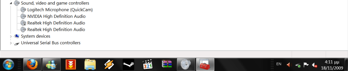

Also when i go to device manager and sound there is nothing about sound it just says nvidia hdmi output.
Also i have windows 7 dual boot with windows vista and i logged in with windows vista and it is fine.
PLEASE HELP I CANT STAND HAVING NO SOUND:p

Can you post some shots showing the relevant sections of Device Manager both from Vista and from W7?

Here are the shots.By the way i downloaded all drivers Nvidia also realtek but nothing

have you disabled any services?
Make sure the Power service is started and set to Automatic

Fixed , thanks guys it was the power service it was disable .!!thanks so much

Type services.msc in run, look for Power, if not started, right click it, Properties, set Startup type to automatic. You can access services through Task Manager as well.
