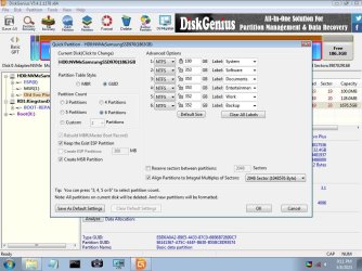

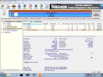

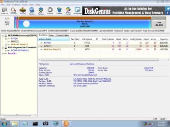

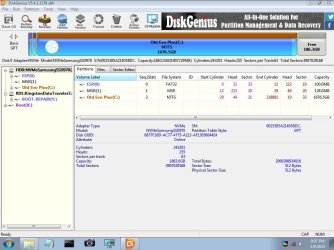

Thanks for the files; sorry for the delay in replying but it took me a little time to realise that the screengrabs were not being saved on the USB drive I had made but could be saved on another USB drive.
I hope they are legible and shed some light!

"no bootloader is installed in the MBR of /dev/nvme0n1"
that is odd. It only applies to mbr partitioned disks.
Your samsung nvme is gpt partitioned and should be booted in efi mode.

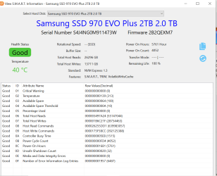

Your hard drive might be a dud. Lots of Info. on the Internet from these crappy Samsung 970s. Here's one article: Samsung seemingly caught swapping components in its 970 Evo Plus SSDs | Ars Technica
Here's another: Update on Samsung SSD Reliability | Hacker News
I believe relatively recently Samsung released a firmware update to fix this. If it's possible, maybe the drive can be connected to another computer and its firmware flashed with the latest via the Samsung Magician software.
Look in Disk Genius' options for SMART data. I'm curious to see what that says.

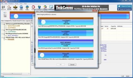

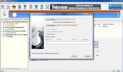

If it is a windows system image, you can apply it manually. I suggest using the free version of diskgenius.
partition the target disk mbr and mark the prospective windows partition Active.

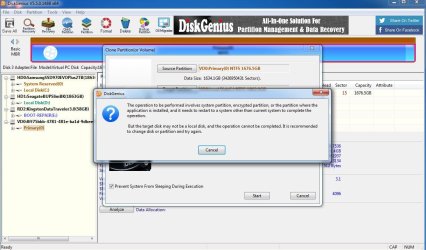

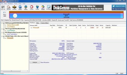

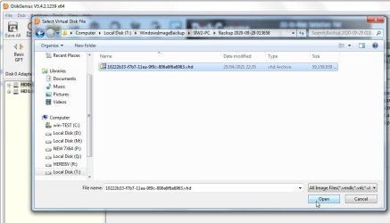

then apply the windows partition from the vhd file using diskgenius like this:
browse to the .vhd file in your windowsimagebackup folder select the .vhd and click Open
the vhd will then appear in the left pane of diskgenius like any other disk.
rt click the windows partition in ths vhd and select clone partition and point it at the target partition on the laptop disk
after it has been cloned to the target partition, fix the drive letter

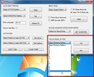

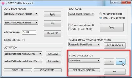

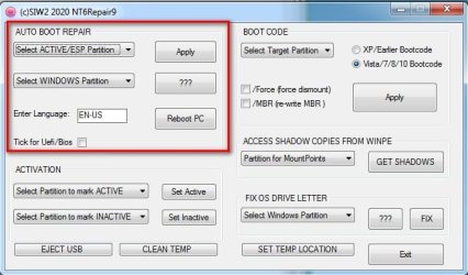

Open NT6repair ( link is on the desktop of my boot media ) select the windows partition letter in the dropdown. Then click FIX
so if you cloned the windows partition from the vhd to partition E: then you must select E: in the dropdown then click FIX
Then you can EITHER use the Autobootrepair section in the picture above.
select the active partition in the drop[dwon
select the windows partition in the dropdown
click APPLY
OR
open cmd prompt and type :
bcdboot windowspartitionletter:\windows /s activepartitionletter:
for example if you have just cloned the windows partition from the vhd to partition E:
bcdboot E:\windows /s E:

Disk genius SMART data:
The drive is an NVME drive and was placed in an enclosure. Connecting the enclosure to a working laptop revealed all the contents of the SSD.

I followed your instructions but, after
I got an error message: c:\windowsSYSTEM32\CONFIG\SOFTWARE HIVE NOT FOUND
What do you think?

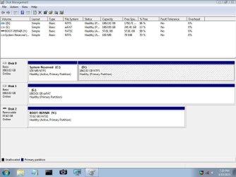

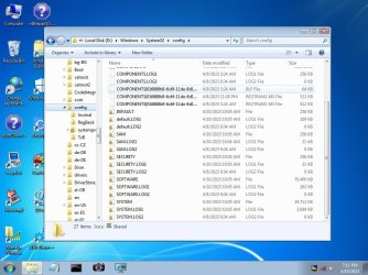

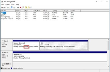

take a look and see if c:\windows\system32\config\software exists.
are you sure c is the drive letter of the partition you cloned to ?
post a screenshot of disk management from the booted media. There is a camera icon on the taskbar. Save the screenshot onto the usb stick so you can post it up here later.

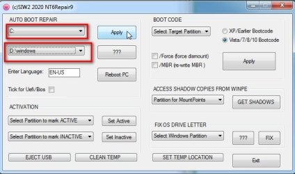

I said that my system image was on a 4TB external drive and indeed it is. "Just in case" I had also copied it to a 2TB external drive.
This morning, the 4TB drive was connected to my W10 laptop so I tried to restore from the 2 TB drive to the W7 laptop. When this failed I tried the 4TB drive but although disk management (and Genius) could see the drive, windows explorer could not - it appears that no drive letter is attached to the drive (another problem to rectify, another day).
I tried the 2TB drive again with the same result: c:\windowsSYSTEM32\CONFIG\SOFTWARE HIVE NOT FOUND
c:\windowsSYSTEM32\CONFIG\SOFTWARE HIVE is on the c drive which is called D drive with the booted media
W 7 Ultimate x64
W 7 Ultimate x64
therefore you need to select D in the dropdown.
the letters you see when booted into winpe are in the winpe registry and are completely independent of the letters assigned in the registry of windows on your hard disk.
then if you use Autobootrepair, you would select the letter of the Active/ESP partition ( in your screenshot the Active partition shows as C )
and select the windows partition ( which in your screenshot shows as D )

Thank you again for the screenshots.
Your botable disk does not contain DiskGenius (as far as I can see) so i returned to my W7 laptop which has DiskGenius and nt6repair to make sure what I was doing was correct. Yesterday I had made a mistake in trying to clone the VHD - I had selected the drive and not the file within it.
Following your instructions on a live w7 laptop and not using your bootable media for the reason stated above, I was unsuccessful. I attach screenshots in the order they were taken:
I guess it is me doing something wrong and I really do appreciate all the help you are giving me.

S1W2,
I have found Diskgenius on your bootable drive and am trying again. Cloning in progress but it it states that it going to take 24 hours! Not sure my old laptop can take it...
Thank you for all your help.
- - - Updated - - -
Update,
It took 11 hours but failed. The error message referred to EFI and BIOS so I looked at your previous advice. I then noticed: make sure you boot the media in bios mode ( do not boot it in uefi mode)
which I had not because, when I tried to boot in BIOS mode, all I got was an unable to find boot disk or similar message. However, on the 4th attempt in BIOS, the programme loaded. Now starting again.

I am not sure why you want to use bios mode and mbr partition style on that machine.
Most people would set the mode to uefi and use a gpt partitioned nvme disk.
Dell XPS 13 9350.
do you need anything that is currently on the nvme disk ?
Dell XPS 13 (2015) - BIOS [v.A03] without comment | ITFroccs.hu - YouTube
General >boot sequence > select uefi
General >advanced boot options > enable legacy option roms
System configuration > Sata option > select AHCI
Secure Boot >secure boot enable > select Disabled
then you could convert the nvme disk to gpt which you would have to do from another os or booted media.

In post number 8 you say:
click APPLY
Sorry to be a bit thick but is the "active" partition your boot disk and is the windows partition the target disk?
W 7 Ultimate x64
W 7 Ultimate x64
it is the partition that says Active on it. Look in disk management.
here is a random screenshot showing where it says Active
the first partition is marked Active in the picture below and the windows partition is the second one.
Yours might be different. In some setups the windows partition is also the Active partition in some setups it is a separate partition.

S1W2,
Success!
Thank you very much indeed for all your very kind help and especially the screenshots without which I would not have been able to reinstall W7 and the system image.
Much appreciated.
