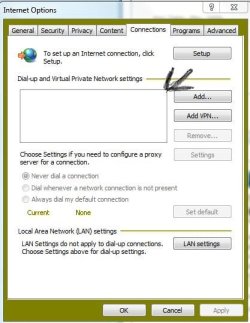

The second thing you can look while in the control panel or a simple right click on the IE 8 tools>internet options>connections is to make sure there are no items like vpn or anything else seen in the small window there. If you are seeing the unable to connect, redial sequence you won't! The image here shows what you should see instead being nothing but an empty window.

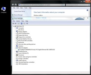

i am using the port built into the board itself (onboard Lan), like u said...my belkin G wireless desktop card, is a pci card thts in the pc...i also have a E/net pci card for the cord...also how do i get to device manager under network adapters? (i played arond on win7 for 3hours last night and went through alot of menus but still no luck,,,,
Windows XP
The device manager itself is found with a new icon for it in the control panel or simply right clicking on the computer icon on the desktop if you have that visible. Right on the upper left side as shown in the image here you then see the device manager link you click on to bring the next screen for the DM itself.
