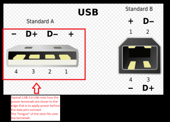

Re the usb point - You're right of course - I never fully inserted it. But just putting it against the socket triggered some sort of 'short'. The 2 outer contacts on the 'plug' aren't recessed much. As you can see, they are very near the edge, perhaps close enough to make contact if you try and insert the plug the wrong way.
Oh meant to mention that is because those two outer contacts are the power supply for the USB the two centre ones are for data. There is a very good but lengthy article available if you want to see and attached is a snip from this site USB - Wikipedia

That's a brilliant link, thanks. Still a lousy design to my mind, considering just how much space and length there is inside. A bit like some HDMI cables where the weight of the cable puts an unnecessary strain on the plug. Optic fibre even worse - I've bought a cheap, thin Chinese job for the home theatre set up. Works a treat and don't have to support the weight of the old cable now which I had to do previously.
