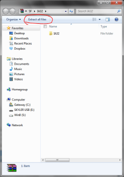

3.Then open the folder and press extract all files and ok.
4. You should see a new folder pop up (the new folder from the extraction in step 3.)

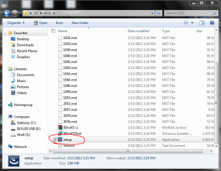

5.Run the Setup.exe file and finish the install.
6.Once it finishes connect your computer to the router with the cable, and then run windows update.
