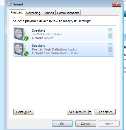

i can see only this
also speacker not detected and microphone and headphone not detected
before i got this problem when i plag microphone i get notification and now no

If you click the icon and then click properties or configure what do you get?
this ?
