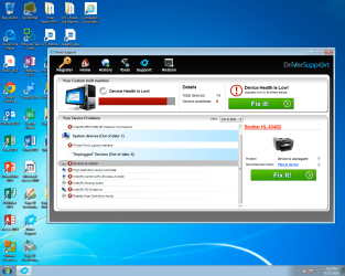

Well here are screenshots of what you asked for. And thank you so much for trying to help me. I have no idea what I am doing…I got the Driver Support from Realtek website and I haven't updated any of those drivers it says are out of date because I am not sure if its safe to do so…

Ok yeah that program is kinda wack, what you should do is first run the support software from apple in the windows install it self as it should be an exe. It should update you to latest drivers that apple is supporting for that machine for windows, then in windows it self since you have basically an all intel system use this tool to check if it finds anything to actually update. Intel® Driver Update Utility
EDIT: this is the one for the mac mini http://support.apple.com/kb/DL1720 the one I linked before might be not for the mini mid 2011.
