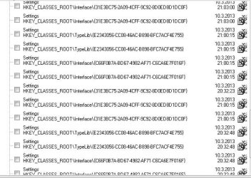

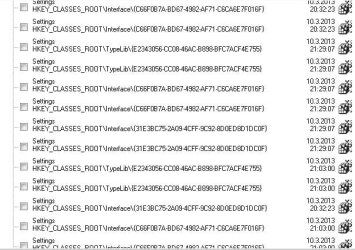

Afeter trying few more things I suspected that some new hardware or software installation on my computer is making a conflict. Before that I used both softwares for few mounths with no problem.
But I dint conect any new hardware in period when error occured. Besides that I deinstalled fresh instalations (flash plugin for browser). So I decided to do full system scan for malware and viruses with few different softwares. With Sypbot Search and Destroy I founded a type op "Browse to save" malware. Couldnt delete instances of it in normal mode but managed to do so automaticly in safe mode. After SB deleted all instances of malware automaticly the things work again prefecly on reboot.
So the problem was "Barrowsoe2Save" wich coused some kind of conflict. Im also attaching an SB log.
I hope the infromation will be helpfull to someone with similar problems.
