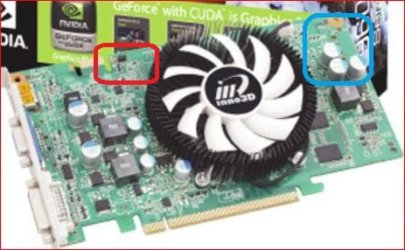

This the card?
Nvidia Geforce 9600+ 1GB HDMI Graphics Card : Nvidia PCI Express : Maplin
If so it doesn't have or need an external power connector. Here is a blow up of the card,
If it needed the extra power connector it would be in the blue square, and is quite clearly missing, so no issue there. I assume the 2 pin connector that you are referring too is the one circled in red. If so that is a SPDIF header and you connect a 2 pin SPDIF cable from that to the one on a sound card, and then you can pass audio over the HDMI connection.
As for the problem with the card it is quite possible that it is a dud out of the box. Not unheard of for that sort of thing happening, and not fun when it happens to you.

All things considering it does sound like a dud card, and you would probably be better served returning it for another.
