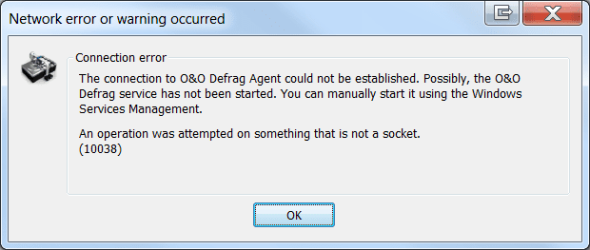

When I just tried to open O&O Defrag, it produced the error shown below. Services does show that the defrag agent is started, but I also selected to restart it, just in case.
I reinstalled the program, and it still produces the same error when starting. When the OK button is selected, Windows pops another error saying that it has stopped working, and of course, that closes the program.
I'm not certain if the 10038 error is part of the first error message or is separate, but I didn't find it Googling. This problem needs help.

Also in the error it states that it cannot connect to the "defrag agent" or service. Have you checked to see if the O&O service is running or not? Make sure it is set to run on startup.

Second sentence from the OP:

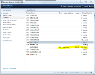

It appears to me that this port is open:

So you're using Outpost for your firewall? Are you using a second firewall? Just had to ask....

No...except the firewall function of my router. Windows firewall is turned off. Unless the previous installation of F-Secure, which I uninstalled is still involved.

When I view application rules, I find the settings as shown previously, but when I simply view the used ports in OutPost's main window, it says that there is no rule. I find this quite confusing, how can a rule be set, but no rule listed?
