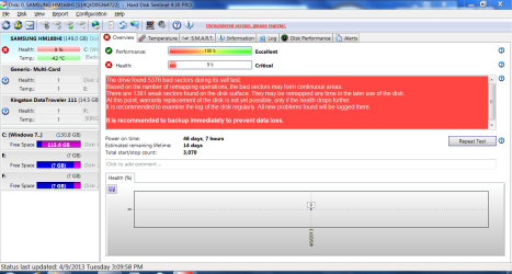

Thanks, Shawn. How about these results:
Capture.PNG.
I'm a bit wary of HD Sentinel trial because it always seems to report bad sectors so I wonder if it's not a sales ploy. So I cross-check it with this:

This is what it tells me now and since it had never annoyed me really.

Greg,
9% isn't so bad, but I would keep backups of the drive to be safe.
I'd also keep an eye on the drive to make sure it's not getting worse.
My rule is: one bad sector is too many. That does not mean it has to be thrown out, but it is suspect. And not to be trusted with sensitive/important data. If any additional bad sectors start popping up then that is the end (at least for me).
