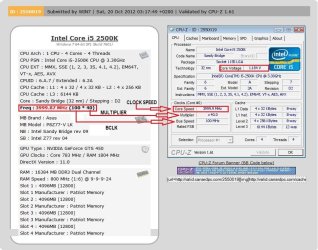

Ok, I need you to put the CPU under load so I can see what the clock speed is.....you don't have to validate it, just use Win7 snipping tool and post it here.
Go here Fossil Free Online CPU Load or Stress Test. and click on 100% and THEN run cpu-z. I'll post mine here to give you an idea of what I need.

That's what I needed to see, good job. It looks like the people who sold you the PC have already Overclocked it to 4.0GHz. I will re-post your pic and show you what some of the numbers mean.
