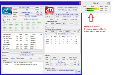

Hello bertie mate run HW Info HWiNFO, HWiNFO32/64 - Download in the right hand panel it will show the cores working or not - see pic - just to make sure one core is not functioning.
Mind you that temp you quoted was very hot and if one core is shot then you may have to replace the CPU. Not hard if you don't mind doing that sort of stuff.

I forgot! I went into msconfig and unticked cpu box, recooted and I then got 2 cpu's in the dropdown, and I also get 2 graphs in Task Manager. So that's good.
