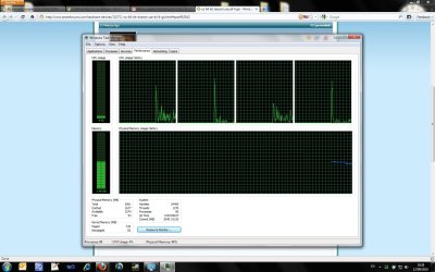

snip a picture of the task manger tab performance and upload it to us.

which tab ?

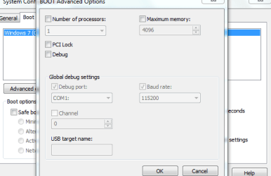

type msconfig in search>go to the advanced tab>look for max memory>uncheck and reboot

check this out.

that's what i did, (my check box is checked) but still i get only 2.99 gb

Did you set max memory to zero (o) & then unchecked ? Click ok, close & reboot computer :)

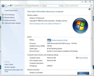

yes, i did it, doesn't help
