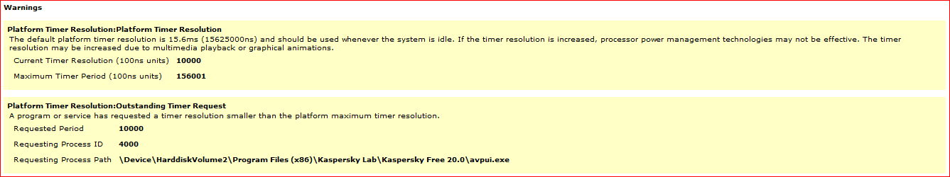

Now, the other thing I notice (thanks to Open Hardware Monitor) is that the system seems to have ignored the option (in the same list of Advanced Power Settings) to put a limit on the Processor Power Management. It has max and min settings for the CPU for each power plan, which were at 100% and 5%. I decided to put it to 90% max to throttle the CPU and hopefully at least get through the rest of the Kaspersky scan (which went fine, hardly breaking into a sweat). But OHM reports it's been up to 100% anyway since then, so I'm not sure what's the point.
I found a suggestion to run a system energy report, which was weird - first off, it didn't save a valid html file (which I've also seen other mention of in this USB issue). I read through it in a text editor and fixed the html, and it shows that various USB devices aren't entering Suspend. Nobody seems to know how to fix that. There are also Timer Resolution warnings and "CPU Utilization:Analysis Error". (I've pasted the output below. I messed up some of the formatting copying it off the page, but hopefully it's readable.)
I've heard that Toshiba bloatware is generally a damn nuisance, and I might try uninstalling that additional app for power management in case it's confusing the Windows one (or possibly I have the wrong version - it was a long hard trek to reinstall Windows and get the drivers after my hdd broke, and it's an old, second-hand machine on its third OS and second drive).
Or is the whole issue from sticking an over-voltage power supply into it? I'd been having battery problems and got a new one, then discovered it was mainly/also the power supply. I discovered I had another one from a completely different machine with the same plug, read the spec and researched online, and decided it was worth a shot. It's been showing no obvious problem (unless that's causing this problem!). The spec on the old one is 19V, 3.4A, but when I tested it with a meter, it was cycling up and down all the time, so I don't know what it was actually putting out. I think they usually give out more volts than they say. The 'new' one is rated at 20V, 3A, but it's putting out a steady 21V according to my meter (same polarity, of course, and with a capacitor or whatever they are just short of the business end). I haven't tried any apps reporting voltages yet, as I've no idea what I'd be looking for. I'll get a correct power supply, but I suspect it's something else. If the other was putting out 20V rather than 19V, then 21V is only 5% over, which most sites say should be fine. If it was actually 19V, then 21 is 10% over, which is a bit much.
Sorry for the long complicated story! Maybe something jumps out as definitely wrong and fixable if you're au fait with these things. It would be nice if I could tweak and then run some full-on CPU test, but I'm concerned that overheating it repeatedly might do it irreparable damage. All this may be a bit early and I should see how things go, but if you spot anything at all that I should do something about, be my guest. It's happily tootling at around 42C at the moment.

Platform Timer Resolution:Platform Timer Resolution
The default platform timer resolution is 15.6ms (15625000ns) and should be used whenever the system is idle. If the timer resolution is increased, processor power management technologies may not be effective. The timer resolution may be increased due to multimedia playback or graphical animations.
Current Timer Resolution (100ns units)10000Maximum Timer Period (100ns units)156001
Platform Timer Resolution:Outstanding Timer Request
A program or service has requested a timer resolution smaller than the platform maximum timer resolution.
Requested Period10000Requesting Process ID4000Requesting Process Path\Device\HarddiskVolume2\Program Files (x86)\Kaspersky Lab\Kaspersky Free 20.0\avpui.exe

powercfg -energy errors
Do clean the fan to help clear overheating.
Correction: the thing nobody seems to be able to fix is to do with USB hubs not going into Selective Suspend - whatever that is - mine is reported as just not going into Suspend. People with that (as per mine) usually say the computer won't sleep, which mine does fine.
Power Efficiency Diagnostics Report
Computer NameJF-TOSHScan Time2020-01-07T21:15:08ZScan Duration60 seconds System ManufacturerTOSHIBASystem Product NameSatellite C660BIOS Date05/09/12BIOS Version2.00OS Build7601Platform RolePlatformRoleMobilePlugged IntrueProcess Count69Thread Count1105Report GUID {d192fd5d-6d59-4163-82b6-413ded7e353b} Analysis Results
Errors
USB Suspend:USB Device not Entering Suspend
The USB device did not enter the Suspend state. Processor power management may be prevented if a USB device does not enter the Suspend state when not in use.
Device NameUSB Mass Storage DeviceHost Controller IDPCI\VEN_8086&DEV_3B3CHost Controller LocationPCI bus 0, device 26, function 0Device IDUSB\VID_0BDA&PID_0138Port Path1,3

The Safe Remove icon should only appear when there is a memory card plugged into the card reader. Is that what happens, on your machine?
No, it doesn't. Other USBs, it does as expected, and when removed those directories also disappear from the file explorers. However, if I right-click on the card reader when it's got a card in and select "Eject", the icon appears along with the "Safe to Remove..." pop-up, and goes again when I take it out. But the icon hasn't appeared for so long I thought it didn't apply to cards and I just hoick them out.
I dont quite understand.
My mistake, it seems. What I thought was this: From the Device Manager, selecting the item in the list, and opening Properties, there's a tab "Details". Here you can select properties from the drop-down list. I noticed "Safe Removal Required", and the value is <false>. I assumed that was why it didn't require safe removal or put the icon there. Now I look again, all my USBs have the false setting, so this may not be what I thought it was.
Yes, although I admit I was not too clear in my earlier post. I meant disable the card reader temporarily, and then re-run the powercfg test. See if the test passes with the card reader disabled.
What I was working towards, was to see if your machine exhibited these symptoms, which in turn could explain the powercfg error report: USB Port Remains Active for Disabled or Safely Removed USB Device | Microsoft Support.
OK, I've done that and the powercfg -energy report has lost a couple of Warnings (errors for the USBs are the same). Photo below.
I don't know enough to interpret the results of the energy test, especially as it didn't run properly and created a scrambled html file that wouldn't even load without doctoring the html (pretty weird). I might be chasing non-problems. Learning though - the card reader E: drive does disappear from Explorer when I disable it! Comes back without a card inserted again when enabled. This could be the correct behaviour - I just vaguely remember it not being shown unless you put a card in, and (as you suggest) that it responded like the USB sockets, with the Safe Removal icon. Maybe have to put all this down to gremlins. Data reads and writes fine to them.
Sorry - should have said - the photo is of the two warnings that didn't show up this time.
