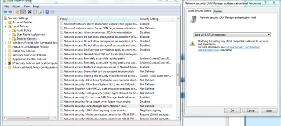

i have a server at my business running windows server 2000 (yes i know i should upgrade, but im making use of equipment we have) with a network share that requires a user name and password to access the share. Within the building there are about 50 computers with OS's ranging from windows 2000 to windows 7. Ive tried logging on with all the machines, but the windows 7 machines will not accept my credentials. under the unsername and password fields it shows the domain as the local computer name. What we have is a workgroup based setup, so aside from upgrading the server OS, is there anything i can do to access this share from the windows 7 machines?

Is it a full drive share ($C:\)?
Are you using homegroup on the win 7 machine, or more importantly are you using IPv6?

1) no
2) no
3) ipv6 is not disabled on the 7 machine if thats what u are asking
7 Home premium
This requires that you change the lanman server parameters in order to get Windows 7 working with older servers. Do these adjustments on the Windows 7 machines that need to connect to the server.
Control Panel - Administrative Tools - Local Security Policy
Local Policies - Security Options
Network security: LAN Manager authentication level
Set to Send LM & NTLM responses only

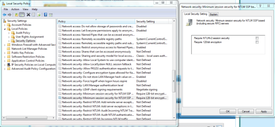

Set the Minimum session security for NTLM SSP
Disable Require 128-bit encryption
The screen shots below should be helpful.
Reboot all machines after making the adjustment.
This has nothing to do with IPv6. ;)
