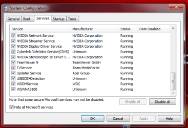

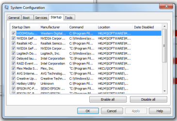

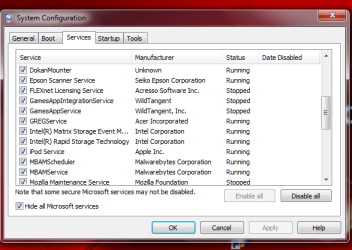

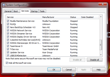

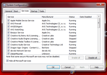

I have uploaded images of msconfig (startups and services). I don't particularly have a slow bootup time, but happy to take any advice on things. Both appear to be bloated on the face of it (services particularly).

OK here are the startup shots, followed by services.
Updated, reloaded corrected startup screenshots (thanks for pointing the issue out- mitchell65)

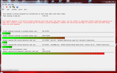

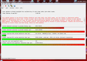

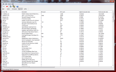

I continue investigations here, and are looking into ResMon there are signs of excessive Deferred Procedure Calls and Interrupt Service Routines (DCP) which may link to the excessif NT System & Kernel usage too. So I downloaded LatencyMon and wow, did that shed some light immediately (or is it a red herring?). (screen shots 1 and 2). I updated the driver (despite Windows telling me it was up to date)
AS can bee seen there is a lot of 'red' and ndis.sys looks like a good place to start. On my machine I have a Ethernet network card and no wireless devices, so all network activity should be 'wired'. I disabled the network card and checked out the effects in LatencyMon (screen shots 3 & 4). Still some red, but a significant enough change to suggest there is an issue in the ndis.sys (network card) worth investigating.
I am considering picking up a new network card to see if that does anything at all - but not optimistic that it will. Online postings suggest this has worked for some people but not enough for me to think this is the 'single fix'.
Anyone got any ideas about ndis.sys, how to check if its been corrupted? how to refresh?
