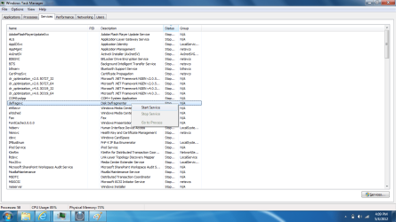

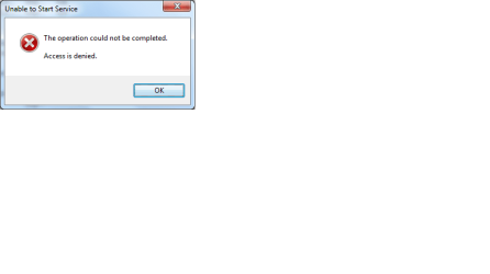

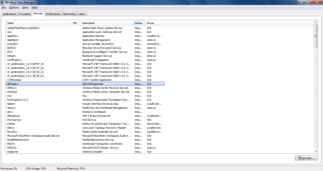

nope it didnt help me man,,, also i am posting some screen shots,, alomost half of services are stopped , when i try to start them ,, access is denied is the message, also my screen getting blank now for like 30 -40 sec total black,, then i get welcome screen when i restart my pc

Okay, see if you can do it this way, on the search bar, type SERVICES
Right click and Run as Administrator.
Find the same service and see if you can fire it from there.

will try it now,, and my windows is 100 % legit and activated...... running SERVICES in ADMINITRAOr MODE didnt help ,, yes i could enable some services ,, but none that were there is the screenshot and browser ..
