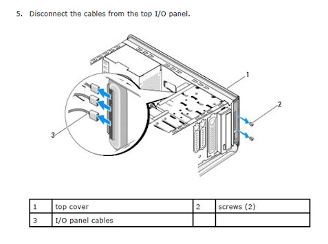

I have never seen a motherboard you didn't have to plug in the power switch on the tower (case).
I asked this question back in post #10 and I haven't been able to find the answer. Could someone guide me to the answer.?
Post #10
What power supply are you using at this time.
This has me confused also. I know nothing about a Dell M/B.
Post # 17
Hmm... Not plugging anything into the front panel switches, they came already attached the MOBO.
I'm trying to understand when this computer gets fixed what fixed it. At the present time my 3 brain cell haven't grasped the answer yet.
Power supply = Corsair Builder Series CX500 as ICit2lol said, the first was noisy & replaced. The new one is quiet.
Here is the front panel for the mini tower which is my PC - nothing to plug in:
2013-10-16
Here is the front panel for the Full Tower which does require disconnecting:
lRoAk1H1CKWQfQ0t_9dY-lKjOs-IGkjgLsehC9vIi6E=w477-h355-p-no
2013-10-16
The fix apparently was removing the AMD drivers &/or Catalyst Control Center.

Were you ever getting a BSOD with this problem?
What I'm trying to figure out is the difference in the way drivers load between booting a PC and Restarting a PC.
To the best of my knowledge their shouldn't be any.
But it might be different from motherboard to motherboard and from Bios to Bios.
Did you or did you not have to plug the wires from the switch into the motherboard?
The reason I'm asking is. If their is one connector from the switches on the tower to the motherboard if that connector is turned 180 deg your prower switch would become your reset switch and visa versa.
In my pea brain two and two is not adding up to four.
No - never a BSOD with this problem.
However the AMD atikmdag driver issue caused BSOD about once a week. But that's an entirely different problem.

I have updated my previous post please read again.
I'm trying to understand what fixed your boot and restart problem.
OK - yes. I'm new @ this. Assumed you meant did I touch the switch on the front panel. I did plug connectors into 15, 17, 21 & 23. Sorry for the confusion :o

Thank you for the picture and the to the point way of answering the questions. That helps.
Did you have to change any of the connection on the motherboard from the way you installed it the first time?
I understand they are keyed.
I'm asking all these questions so I and all the other people reading our post from around the world can have a better understanding.
No change, this MOBO is exactly like the one it replaced. The connections only go on one way so really impossible to put them on incorrectly.
