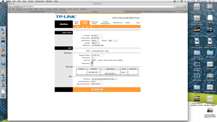

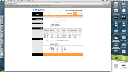

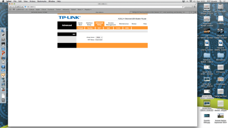

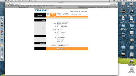

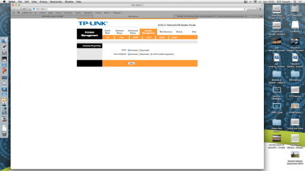

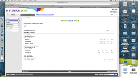

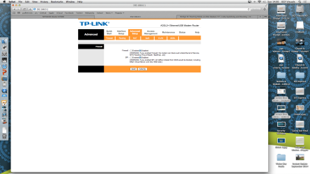

No problem. I've been preoccupied as well. I took some screenshots on Sunday of the setup of the modem as follows.
The TP-Link Modem is connected to the WAN port of the Nighthawk, every device is connected to the Nighthawk which gives out the IP's, the firewall is only disabled on the modem and is enabled on the nighthawk. I believe I may have found the "answer" reading other forums: the modem is set to bridge mode which seems to be correct, but at present the Nighthawk has a static IP to the Modem rather than being set to PPPoE & inputting the ISP username and password.
Hopefully the screenshots provided will help you understand what is going on and how things are set up :)

Sorry, can’t find any helpful setup guide from Hotchilli Communications website or searching the web, but I did check other Providers setup in UK which gave me some ideas.
Setup your ADSL Modem and Router by following this guide. I would stick with my previous post by assigning the same subnet - for your Modem (192.168.0.1) and your Router (192.168.0.2). Try the Bridge Mode first then assign Static IP to the Router, if Bridge mode didn’t help, try the PPPoE.

CarvedDuck, that's what I ended up doing except I kept the different subnets. I accidentally tapped "DELETE" in the modem's WAN setup page which reset the settings then had a fight to get it to accept the VPI/VCI settings. There were multiplay PVC circuits in the modem which you could select from, PVC6 was 0/38, after that I had to enable the virtual circuit and set it to 0/38, without setting it up that way it wouldn't accept it if you used a different PVC Circuit and still input 0/38, it would fail due to there being a duplicate circuit with those settings.
Either way I set it up as PVC6 0/38 in 1493 Bridged Mode then set the router up as PPPoE with the ADSL credentials, saved and the router rebooted and the port forwarding worked.
