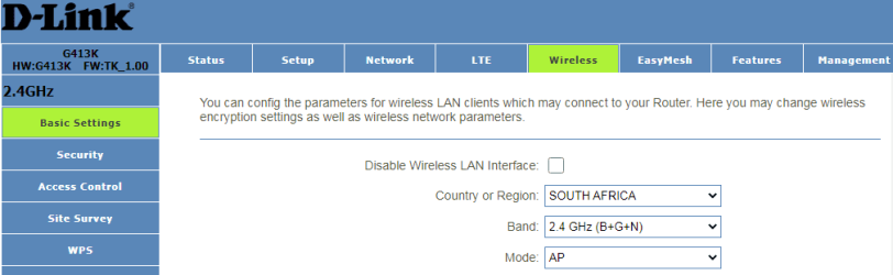

Have you connected via usb as you try and connect on the router is there an option to set wireless to N type the router is AC and you card is only N type which may be the problem
win 8 32 bit
Hi.
Please confirm if this is what you are referring to?

yes that right
