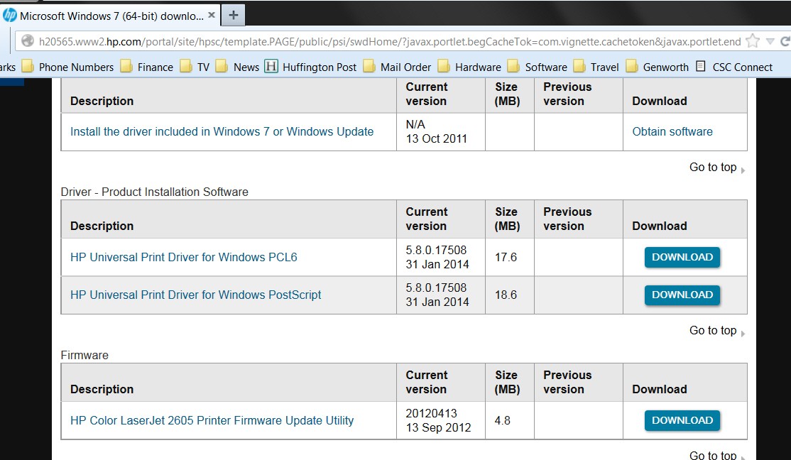

The 5.8.0.17508 driver I installed (for both PS and PCL6) is from the page with the link I provided in my first reply:

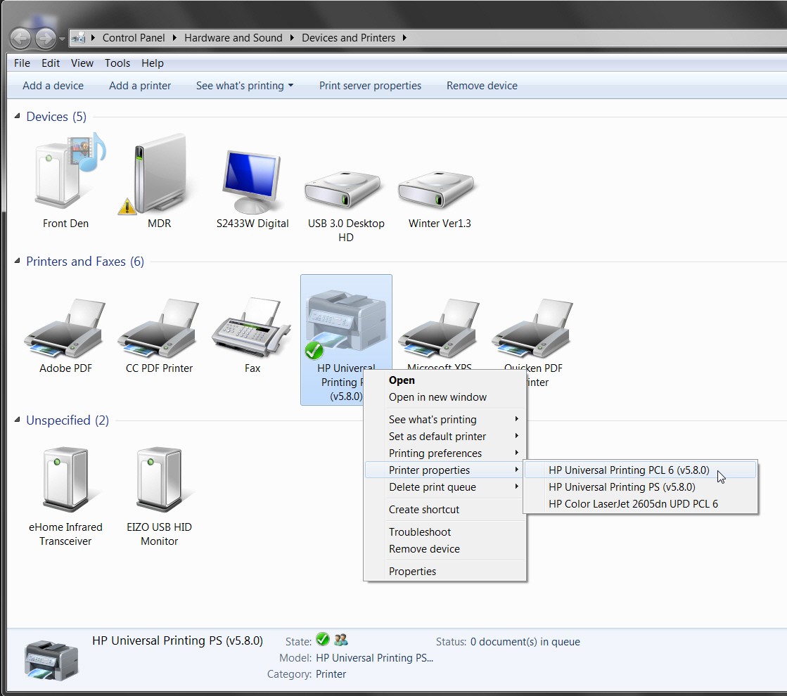

Ended up with new printer and ICON looked like a floor model. Printer didn't work when trying to print a test page.
If you go to "printer properties" -> "ports" tab, you'll probably not see "USB001" which is the proper port you should see. If you don't see "USB001" then you really won't be able to print, and printing a test page will fail.
Installation of a "second printer" should select "local printer", and "use existing port", and select "USB001" (which was already created by Windows when it auto-installed the PCL6 printer when you first powered it on).
You might just start over. Go to "Devices and Printers", right-click on the printers that are there and then select "remove device". When you have any/all of these 2605dn-related objects gone power the printer off and re-boot. Then power the printer on and Windows should automatically auto-install the PCL6 driver.
Optionally, you can then run the PCL6 driver you've downloaded (from the HP site) but I believe it'll in all likelihood be the same 5.2.0.17508 driver as Windows probably just installed automatically. Nevertheless if you just proceed, you'll end up with two PCL6 printers. Not a problem. Again, select "local printer" and "use existing port" and select USB001.
Then you can run the PS driver, again choosing to add "local printer" and "use existing port" and select USB001.

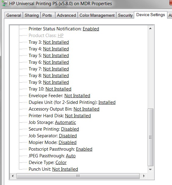

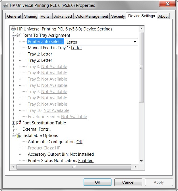

As for what is seen under the device settings, down at the bottom under Installable options I see Automatic Configuration with choice of OFF or UPDATE NOW. Next line up from that is Mopier Mode which is set to disabled. Not sure what Mopier Mode is.
I also show "automatic configuration: OFF", but I don't show "Mopier mode" above it. Instead, "Mopier mode" is below it.
Here is what my 5.8.0.17508 driver shows BELOW the "automatic configuration: OFF" line (note that the second-to-last line is "device type: color" which is what I manually set):

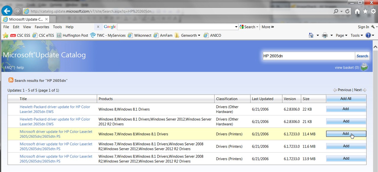

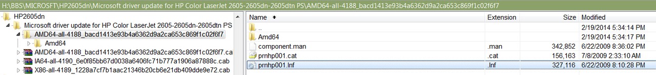

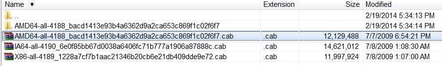

Your device setting screen is a lot different than what I'm seeing. Here are a couple shots to show all the settings.
As for your first screen shot, been to that page and another one or two showing the same UPD drivers.
Forgot exactly all I did when I tried to install the PCL drivers. Currently the printer is set up for USB001.

Assuming we're now talking just about PCL6 and not PS (as my earlier screenshots were for, since that's actually the only printer I use by default), here is what my current 5.8.0.17508 PCL6 printer looks like. Note again that I have THREE separate printers shown with ONE PRINTER ICON, because that's how Windows presents it. One of them (the original PCL6 driver) occurred automatically when I powered on the printer and Windows automatically recognized it and auto-installed the PCL6 driver and created USB001 port. The other two (the official 5.8.0.17508 versions) for both PCL6 and PS are also shown in the flyout for either "printer preferences" or "printer properties".
So, if I then select "printer properties" for my own added PCL6 driver, here is what the ABOUT looks like. Note the difference in the PPD member, which is NOT the same file name as you say is on your machine. Again, this says to me you didn't download the specific driver for the 2605dn from that page, else you couldn't show a different PPD file name.
And then if I go to the "Device Settings" tab, here is what is presented:
I recommend you "remove device" for whatever you have, and do a fresh download from the HP driver page I provided the link for, and start from scratch again. The different PPD name is a "giant clue"that you have a different driver installed than you should.

* Next go to the pg you've shown with both of the latest drivers. DL both drivers separately. Make sure they are set up to use the USB001 port.
* After this I should see all the drivers listed like you've shown under printer properties.
* When I go to Device Settings, I should then see the same items that are shown on your machine.

Did you set the "duplex" setting to INSTALLED? Did you change the "device type" setting to COLOR?

Just one more post-mortem observation (I'm simply not willing to give up until I get to the bottom of the mystery to my satisfaction)...
As I look back at your "Device Settings" -> ABOUT screenshots from your original auto-installed driver (which clearly shows it as being a PS driver using HPMCPD25.PPD, and not a PCL driver as I'd just assumed it would be) and compare them to my own (which were from my latest 5.8.0.17508 PCL6 driver), I see that your device title is different from mine (even from my own PS driver), showing as "HP Color LaserJet 2605/2605dn/2605dtn PS".
Also, the copyright date statement from HP on the ABOUT page is also very different. Yours shows 2005 as the copyright date for that HPMCPD25.PPD PS driver, and the latest 5.8.0.17508 from HP shows 2013, for both my PCL6 and PS printers. I still can't imagine how the auto-install your Windows 7 system went through (which used Windows Update to go up to the Microsoft driver repository in the cloud to retrieve what presumably would then have been the "most recent" driver) would have ended up with a 9-year old version of that driver! And a PS driver at that, rather than a PCL driver as occurred on my own machine.
Now true, the driver retrieved automatically from MS's driver download site is whatever HP (the vendor) most recently provided to MS. That's also how some other hardware driver updates get "pushed out" with Windows Update, from the vendor to user through Windows Update. But in this case the implication is that HP hasn't updated the drivers given to MS since 2005?? Is that really possible?
Anyway, in the 8 years since I've had my 2605dn, I've probably done six Windows 7 installs "from scratch" where the first time auto-install (at power-on) for the correct driver for the USB-attached printer went through its motions, I have NEVER ended up with a PS driver with a copyright date of 2005. It has ALWAYS been a much more recent PCL6 driver that I ended up with (can't recall now if it was actually the same as the "most recent" PCL6 driver downloaded from the HP site itself, as it's been quite a while since my last Win7 install on the machine to which the 2605dn is currently USB-connected).
But for absolute sure I do remember that it was always a PCL driver, not a PS driver as you show in your screenshots.
Furthermore, as I mentioned previously, although I did find HPMCPD25.PPD on my machine in the Windows \Driver Repository, my research suggests it is PS for an HP 2800 series printer, not an HP 2600 series printer. I wonder if this is tied to your particular HP Z-series machine itself? Is this a Win7 pre-installed by HP, or did you do your own subsequent reinstall-from-scratch?
In other words I wonder if something already in the \Driver Repository on your machine (with an HP-pre-installed Windows 7) told the auto-install process (when you powered on your new 2605dn) that your local PS driver for a 2800-series printer (a) somehow also applied to the 2605dn hardware id, and (b) was "more current" or appropriate than the PCL6 driver which I'm sure is on the MS driver repository in the cloud??
Ok. Enough blabbering speculation and questioning.
To satisfy my own curiosity, I went directly to the Microsoft Update Catalog site (where Windows Update goes for software updates and drivers, but you must use IE and not Firefox as otherwise the page won't open properly). I then searched for "HP 2605dn" and received the following hit list (showing three drivers eligible for use with Win7):
Although the annotation appears the same, my experience is that typically these three drivers offered are for (1) x86, (2) x64, and (3) Xeon processors. So I selected all three and downloaded them, and sure enough what I got were the predicted three driver CAB variant packages, and I then expanded the x64 version:
which revealed the sought-after INF file inside, namely PRNHP001.INF:
I then looked inside PRNHP001.INF using NOTEPAD (with "wordwrap" enabled so I could take a complete screenshot) and looked down at the item for the 2605dn printer (see highlight in the following screenshot):
Well, sure enough, now that I can see inside this PRNHP001.INF it's clear that the corresponding driver obviously is a PS driver and is EXACTLY THE ONE YOU HAVE BEEN GETTING, and which uses HPMCPD25.PPD!!! It is also named exactly the same as is shown in your ABOUT screenshot, and I suspect that while the MS download site shows it as version 6.1.7233.0 dated 6/21/2006, my guess is that that it would have your 2005 copyright date inside and other matching specific details.
Amazingly, it absolutely IS a PS driver and not a PCL6 driver. This is very definitely different from the last time I did my own auto-install for the 2605dn and which resulted in a PCL6 driver, and not a PS driver. Obviously if I were to do a fresh reinstall-from-scratch today for Win7, that when I first powered-on my 2605dn and the auto-install was done, that I too would be given exactly this same driver as it is what is now being offered through Windows Update and the MS update catalog site.
I'm guessing this is all tied to what they did to update of the MS driver site in support Windows 8/8.1 as well as previous Windows 7 environments. Note from my screenshot above that they also have two drivers specifically for Windows 8/8.1 only (they look like small "bootstrap" files, not the complete driver files), with a newer version 6.2.8306.0, although also dated 6/21/2006. Seems very strange as Windows 8 was not around back then, but who knows how these things get titled and dated?
Note that the file dates of these objects goes back to 2009, when HP was probably doing its development for Windows 8 drivers before handing them over to MS for inclusion 3 years later in the released finished Windows 8 product.
Anyway, I have now satisfied my own curiosity as to why you got what you got. It has nothing to do with your HP-Z machine. It has everything to do with what's now on the MS Windows Updates site for this printer. And apparently HP has decided it should be the PS driver that gets auto-installed, and not the PCL6 driver... something I'm all for.
Yes, this is STILL NOT THE LATEST DRIVER AVAILABLE THROUGH HP (which is 5.8.0.17508 and dated January 2014, which oddly seems to have a lower number than either 6.1.7233.0 or 6.2.8306.0 as shown on the MS site, both of which are dated June 2006!!), but at this point I don't care anymore!
I'm only finally satisfied that I at last understand WHY you got what you got, and why the ABOUT information shows what it did.
I'd say "case closed".
