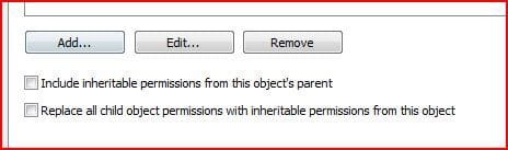

Ok it appears that something is amiss.
what I would suggest is completely removing all permissions on the drive and re-setting them to how you want them ....
Log in as the built in administrator (takes UAC out of the loop), at the root of the drive in the advanced permissions screen
make sure that the two check boxes are not checked, remove all permissions and then set the permissions you want for the drive. this just sets the permissions on the root
Remember that due to the way that UAC works, giving permissions to the administrators group, will not give permissions to your user for normal use, so both needs to be added
now go to each folder in the level directly beneath the top level and in the Advanced permissions check the both boxes and apply - agree to the warning box and let the system set the permissions - this will take a while depending on the number of files

Thanks a lot! It seems to be working. However for the root D: I had only one check box available, for the 1st level dirs - both of them. I have also removed the read only flag. Recycle bin reports it is corrupt. I think now it is OK.
