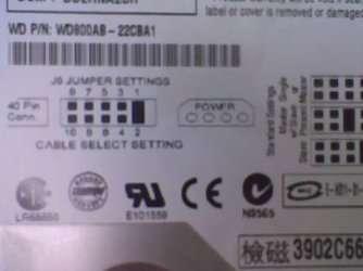

Just waiting for the batteries to charge so I can take a photo but looking at it it does say Cable Select Setting under a box that has numbered blocks in it, will that make a difference ?

For the Ext enclosure, it needs to be set to Master or Single drive.

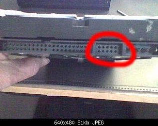

This may be something I'll have to leave for my son-in-law to do then as I'm not really sure how to do it and I can't get a decent photo to show what it looks like.

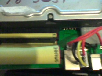

OK these photos are the best I managed they are from my phone.

You should try the following options: Single (Neutral Position) (try both alternatives) or Single (Standard Installation) or Dual (Master) (my recommendation).

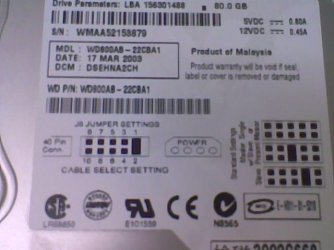

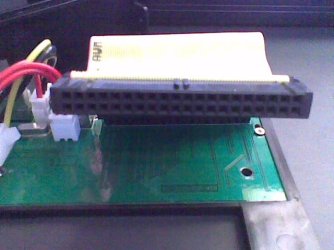

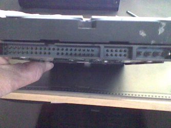

Just taken these two photos, one is the back of the hard drive and the other is the ribbon connector from the enclosure.

joan, looking at your pics, it seems that it's already set to 'single' or 'master', as there is no small plastic 'jumper' on the middle five pins.
...and the ribbon connector can only go in the one way.
sorry i don't have a solution, apart from saying that everything looks right. :o

Thanks mickey, that's what I thought when I looked at it again and I knew the ribbon could only go in one way. Because I've never done any of this before I had no idea what it was supposed to look like and not seeing anything that looked movable I was stumped.

Yes, the jumper configuration looks correct for Master or single & the ribbon cable looks okay, also. I guess we all will have to put on our thinking hats for this one.
