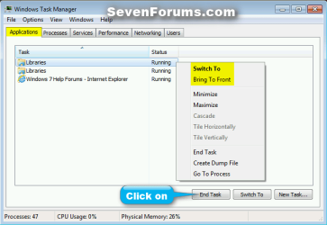

2. To End Task in Applications tab of Task Manager
Note
The Applications tab will show you a list of all apps that are currently running under only your user account.
2A) Click on the Applications tab, do step 2B, 2C, or 2D below, and go to step 4 below. (see screenshot below)
2B) Right click on a task (ex: Libraries), and click on End Task.
OR
2C) Click on a task (ex: Libraries), and click on the End Task button.
OR
2D) Click on a task (ex: Libraries), and press the Delete key.
Note
If you like, you can use Switch To or Bring To Front to determine which window belongs to the task.
Switch To = Minimizes Task Manager, and brings to front the window of the selected task as the active window.
Bring To Front = Has the window of the selected task as the active window displaying up front and on top of any other windows.

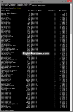

2. In the command prompt, type tasklist, and press Enter. (see screenshot below)
Note
The tasklist command will display a list of all the processes that are currently running on the computer from all users.
Make note of the Image Name or PID of the process you want to end.

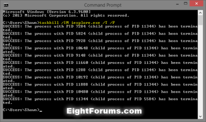

4. To Forcefully End Process using Image Name of Process
A) In the command prompt, type the command below you want, press Enter, and go to step 6 below. (see screenshots below)
(To end this process only)
taskkill /IM ImageName /F
(To end this process and any child processes started by it)
taskkill /IM ImageName /T /F
Note
Substitute ImageName with the actual image name (ex: iexplorer.exe) from step 2 above.
If you would like to end more than one process at once, then you can add /IM ImageName for each one. For example:
(for two)
taskkill /IM ImageName /IM ImageName /F

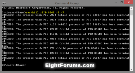

5. To Forcefully End Process using Process ID (PID)
taskkill /PID ProcessID /F
taskkill /PID ProcessID /T /F
Note
Substitute ProcessID with the actual PID (ex: 5476) for the process (ex: iexplorer.exe) from step 2 above.
