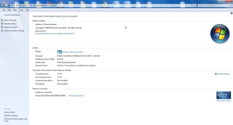

The only thing that i can see is that Service Pack 1 has a problem or is not installed.
please post a screenshot of control panel > system, see mine

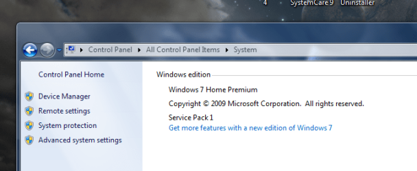

Thanks, here is the screenshot. I have SP1. The only thing I had done in the past was to add group policy to 7 home premium. I can't remember how I did it though, it was some time ago.

Sometimes it takes 3 runs of that prog to actually fix everything.
If your not having a problem with windows upodates, then i wouldn't be worried if it was on my system.

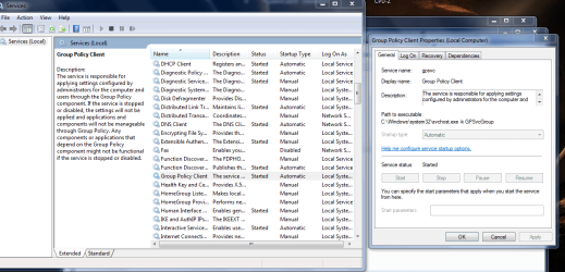

I am curious about your group policy change as its not part of Home premium as such, but is listed under services, see attached
NOTE THE GREYED OUT AREA, startup type.
