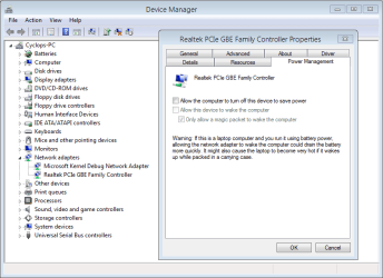

Check the controller properties, as shown below, and ensure that the option Allow the computer to turn off this device to save power (Spanish: Permitir al equipo apagar este dispositivo para ahorrar energía) is unchecked, as shown below. Then reboot.
thanks for the translation!:D
and yes, that option was checked, i will use that computer for the whole day to see if the problem came up again.
Checked? It should be unchecked. ;)
Yeah, sorry i meant unchecked, and since that last message i have been using that computer solving the a video driver issue, downloading drivers files.. you know.... and no yellow flag.
so, i think i can check the thread as solve.
