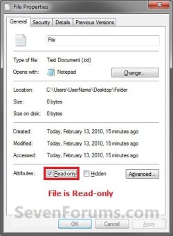

1. Select one or more files, right click on the file(s), and click/tap on Properties.
2. To Set the File as Read-only
A) In the General tab, click on the Read-only box until checked, and click/tap on OK. (see screenshot below)
3. To Set the File as Not Read-only
A) In the General tab, click on the Read-only box until unchecked, and click/tap on OK. (see screenshot below)

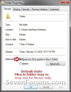

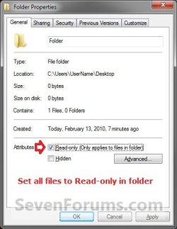

1. Select one or more folders, then right click on the folder(s), and click/tap on Properties.
2. Click/tap on the General tab. (see screenshot below)
NOTE: When the Read-only box is blue, this is the default undetermined state. It does not mean read-only or not read-only.
3. To Set All Files in a Folder as Read-only

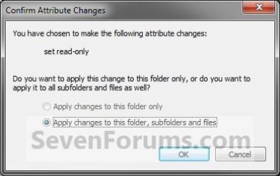

A) Click on the Read-only box until checked, and click on OK. (see screenshot below)

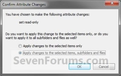

B) Select the option you want, and click/tap on OK. (see screenshot below)

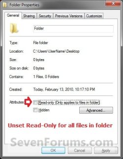

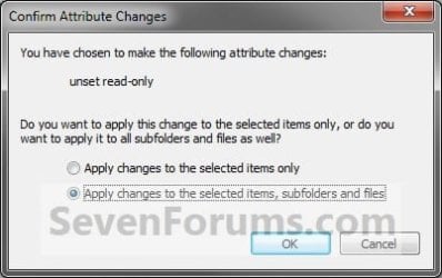

4. To Set All Files in a Folder as Not Read-only
A) Click on the Read-only box until it's empty, and click/tap on OK. (see screenshot below)

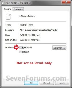

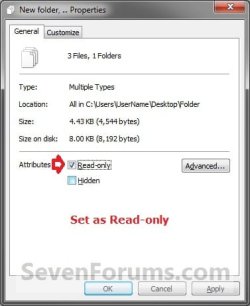

For Multiple Files and Folders
NOTE: This option is if you want to select multiple files and folders at once to have the files and all files in the folders set or unset as read-only.
1. Select one or more files and/or folders, right click on the file(s), and click/tap on Properties.
2. To Set as Read-only
3. To Set as Not Read-only

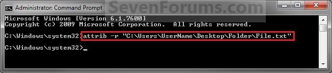

3. To Set a File as Not Read-only
A) In the command prompt, type the command below, and press Enter. (see screenshot below)
NOTE: Substitute "Full path of file with file extension" for the actual full path of the file.
attrib -r "[B][COLOR=red]Full path of file with file extension[/COLOR][/B]"
FOR EXAMPLE: I would type this command exactly as below for a file named file.txt in a folder on my desktop.
attrib -r "C:\Users\UserName\Desktop\Folder\File.txt"

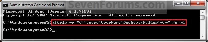

3. To Set All Files in Folder and subfolders as Not Read-only
NOTE: Substitute Full path of folder for the actual full path of the folder.
attrib -r "[B][COLOR=red]Full path of folder[/COLOR][/B]\*.*" /S /D
FOR EXAMPLE: I would type this command exactly as below for a folder on my desktop.
attrib -r "C:\Users\UserName\Desktop\Folder\*.*" /S /D
