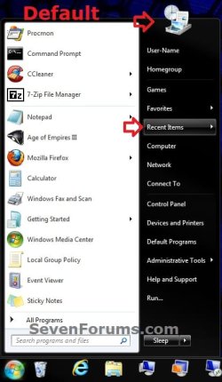

EXAMPLE: Recent Items in the Start Menu

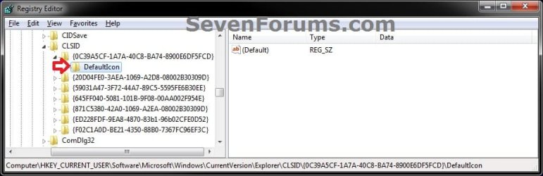

G) In regedit, navigate to the location below. (see screenshot below)
NOTE: This will be the registry locations added from steps A to D.
HKEY_CURRENT_USER\Software\Microsoft\Windows\CurrentVersion\Explorer\CLSID\{0C39A5CF-1A7A-40C8-BA74-8900E6DF5FCD}\DefaultIcon
H) In the right pane of DefaultIcon, right click on (Default) and click on Modify. (see screenshot above)

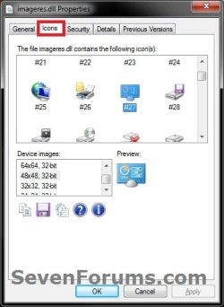

J2) In Windows Explorer navigate to the .exe (ex: for program icons) or .dll (ex: Windows 7 icons) file that contains the icon that you want to use, right click on the file, click on Properties, and the Icons tab. (see screenshot below)
NOTE: The most common Windows 7 icons are in the C:\Windows\System32\imageres.dll file.
J3) Make note of the icon number for the icon that you want to use instead. (see screenshot above)
NOTE: For example, the default Recent Items icon number is 117.

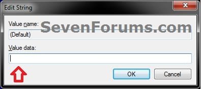

J4) In the Modify window from regedit, type in the full path of the .exe or .dll file followed by ,-icon# (full path,-####) and click on OK. (see screenshot below)
NOTE: For example, if I wanted to use the path (step J2) and the 100 icon (step J3), I would type:
%SystemRoot%\system32\imageres.dll,-117
OR
C:\Windows\System32\imageres.dll,-117

K1) In the Modify window from regedit, type in the full path of where the custom icon (.ico) file is saved at with the file extension in quotes, then click on OK. (see screenshot below)
WARNING: You will need to use a 256x256 pixel icon that was made for Windows 7 and Vista for them to display properly at all of the available icon view sizes in Windows 7. You will also need to leave the icon saved at the exact location you typed below for it to continue to work. If you delete or move this icon, then it will no longer be displayed.

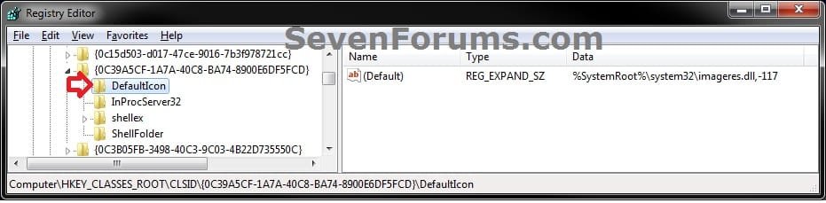

C) In regedit, navigate to the location below. (see screenshot below)
HKEY_CLASSES_ROOT\CLSID\{0C39A5CF-1A7A-40C8-BA74-8900E6DF5FCD}\DefaultIcon

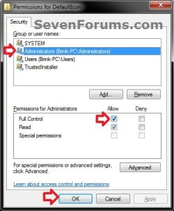

D) In the left pane, right click on DefaultIcon, click on Permissions. (see screenshot above)
E) Select your Administrators account, check the Allow box for Full Control, then click on OK. (see screenshot below)
F) In the right pane of DefaultIcon, right click on (Default) and click on Modify. (see screenshot below step 1C)

H2) In Windows Explorer navigate to the .exe (ex: for program icons) or .dll (ex: Windows 7 icons) file that contains the icon that you want to use, right click on the file, click on Properties, and the Icons tab. (see screenshot below)
NOTE: The most common Windows 7 icons come from the C:\Windows\System32\imageres.dll file.
H3) Make note of the icon number for the icon that you want to use instead. (see screenshot above)
H4) In the Modify window from regedit, type in the full path of the .exe or .dll file followed by ,-icon# (full path,-####) and click on OK. (see screenshot below)
NOTE: For example, if I wanted to use the path (step H2) and the 100 icon (step H3), I would type:
OR

I1) In the Modify window from regedit, type in the full path of where the custom icon (.ico) file is saved at with the file extension in quotes, then click on OK. (see screenshot below)
WARNING: You will need to use a 256x256 pixel icon that was made for Windows 7 and Vista for them to display properly at all of the available icon view sizes in Windows 7. The icon will need to be saved in a location that all users have access to. For example, in a C:\Users\Public folder. You will also need to leave the icon saved at the exact location you typed below for it to continue to work. If you delete or move this icon, then it will no longer be displayed.
