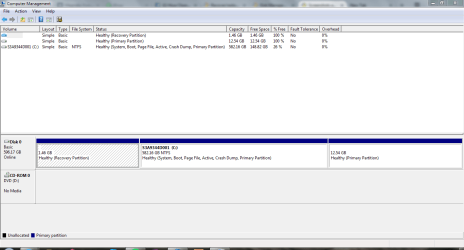

This is my current setup:

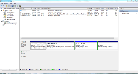

This is the oldest screenshot I can find of my setup, but this is one year after I removed the Windows 8 Developer Preview:
Yup, I followed the guide here to remove the partition by deleting the Windows 8 partition and extending the Windows 7 partition.
If I'm not mistaken, I ran the Startup Repair from the System Repair Disc I created earlier (my version of Windows is preinstalled - I don't have the discs) to restore the MBR. It reported success I think. I might also have used the EasyBCD tool to restore the MBR.
It's the Windows 8 Developer Preview, thus it shouldn't been preinstalled but installed by me. Windows 7 is definitely preinstalled.

Run Startup Repair - Run 3 Separate Times from the System Repair Disk no matter what they report. Post back any findings.
It's hard to know for sure (unless you do) whether Recovery was originally marked Active which is how some OEM's make them bootable in case you want to Recover. You could try moving the Partition Marked Active to Recovery and then run a few Startup Repairs if necessary to see if it picks up Win7 boot files there and starts. It shows in blue link how to move Active flag back if OS won't boot.
There are some other options to try in Troubleshooting Windows 7 Failure to Start including Rebuilding the BCD in Step 5 and constructing a System Reserved partition from Step 10.
Using Copy & Paste - in Windows Recovery Console from Repair CD you could also explore to see if there is indeed a Boot folder on Recovery proving it is intended to be the System partition, delete the Boot folder in C and replace it with the pristine copy I've zipped up below which you'll need to first extract to flash stick.
Before attempting any of the fixes besides Startup Repair I'd save a backup image of C using Macrium Imaging - Windows 7 Help Forums .
If you'd like to Clean Reinstall Windows 7 it discusses how to find reinstallation media in Step 1. We can help you. If upgrading to Windows 10 refreshes System Recovery Options as I'd expect then you can also wait to do the Clean Reinstall with the ISO which MS plans to provide once you do the in-Place Upgrade that secures your license.
You could also run Recovery from your disks to replace everything including the Recov partition.
