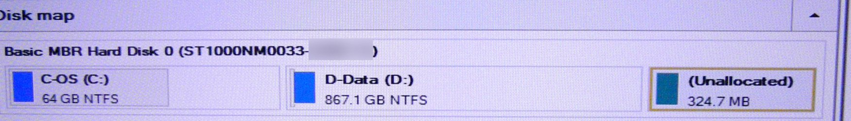

Can you post a screenshot of the partitions so we can see? Is this MBR. Disk with MBR you can't boot to a partition past 2gig as there isn't enough code space
win 8 32 bit
win 8 32 bit
Thank you for the reply, samuria.
I do have the motherboard set to use BIOS not efi.
There is a MBR which I restored from the Windows 7 image backup.
The Windows 7 partitions are NTFS.
The size of the hard disk is 1 TB.
I can only do a screenshot by photographing with a camera and then uploading the jpeg.
Would this be helpful?
Windows 7 Pro 32bit and Windows 7 Pro 64bit
That would help

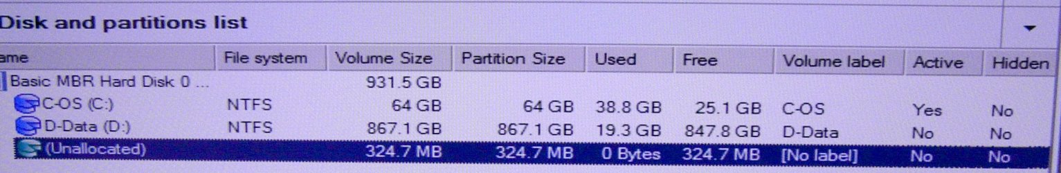

Okay, attached are two photos from Paragon Disk Manager Pro 15 Win PE 3.0 Recovery Disk

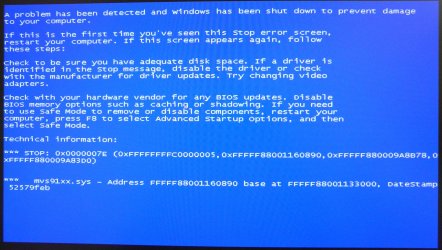

Here is a photo of the bsod when it tries to boot.
It does not like some aspect of the Marvell Driver, but I cannot understand whether it is missing, wrong, too old, too new, or what?
