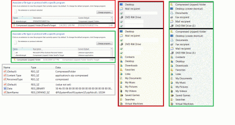

The attached imagine is a few screenshots of comparisons. RED My user profile, GREEN Local Administrator, GREY is netural to both profiles.
1) Registry for .zip folders on both users are identical. Maybe there is another place in the registry that pertain to this option?
2) Why would the Local Admin Association have .zfsendtotarget assigned to an Unknown application, but yet respond as if Compressed Folders works? Whereas my profile says the associated application is Compressed (zipped) Folders.
3) I have tried unloading the .dll, as via descriptions for XP/VISTA/7 on multiple websites, this method errors with some "RegisterSendTo," if this method is familiar to you-how did you manage to unload the .dll, then what?

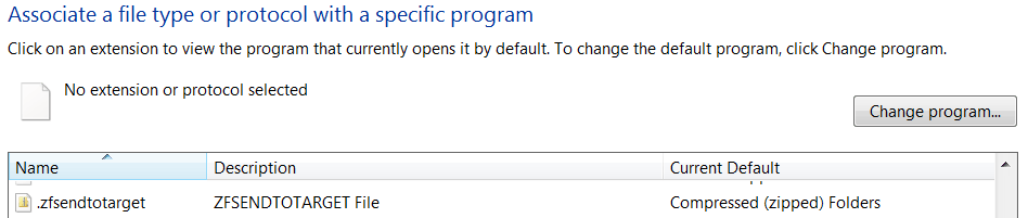

I ran the ZIP file associated registry restore, and re-logged. No luck, as such as I expected. In my file associations the results remain the same. (picture) :cry:
For anyone that doesn't use a 3rd party app for compressed folders, what's you file associations for .ZFSENDTOTARGET say? (By comparasion to my picture)

Mine shows a different default for .zfsendtotarget. Try the REG file below to restore the defaults for this to see if it may help.
Works wonders! Cannot believe this issue is resolved, well ALMOST...

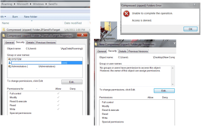

When I right and send to, 2 things happen:
1) The name isn't "Compress (zipped) Folders," it's "Compress (zipped) Folders.ZFSENDTOTARGET" (picture).
This is hardly a concern of mines, I'm just thankful that the option is back in the shell, but Curious as to how to change it.
2) NEW PROBLEM(Well same problem as I had on the Local Admin Account), I cannot send a folder with contents to a compressed folder, because it says I do not have permission. (picture) How would I change the permissions related to SendToCompressedFolders?

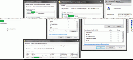

I tried this method before you finally fixed my SendTo option. But i decided to go ahead and create a new admin account again. GREEN denotes the new local administrator account.
No luck with this method either, I tried send to compressed folder both on Desktop and My Documents.
I have 2 computers with this same exact issue and it's mighty frustrating. No matter what permissons you set, the error seems to exsist.
NOTE:
- I can access the other computers C drive from my computer and compress folders, but if your at the workstation itself, access is denied. This begs the uppercase question...WHY WOULD YOU LET A RDP COMPRESS SOMETHING WHEN AT THE COMPUTER YOU CAN'T?
Here is some SS's of my settings for folders/areas. (picture)
EDIT: I had SYSTEM Hightlighted instead of admin for FOLDER I WANT TO ZIP PROPERTIES, I just checked, the settings are the same for the new local admin account.
