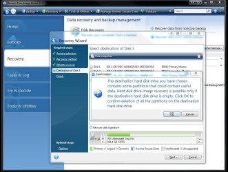

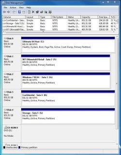

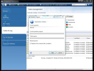

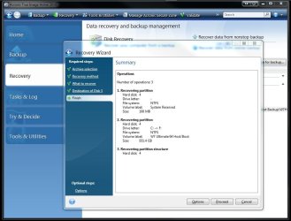

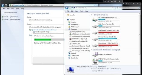

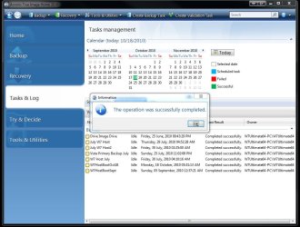

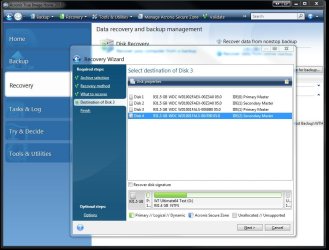

Greg is quite correct about both WD and Seagate having their own free versions of the Acronis Disk Director suite. I used the WD version on the WD drives here at times but went for the full version I grabbed up at a local office supply store.
1) The first step is deciding which method you will use. 1) direct clone or 2) restore image made from original source drive(Drive #1)
2) The setup for seeing a dual boot of two drives gets involved to see the best actual working results. The host/boot was first backed up with the image option found in the CP>Backup & Restore for that drive. The second drive saw an image of the first drive made with Acronis.
Note the 3rd drive is the last since that will first need to hold the image to be restored on the new host/boot drive. Once the image is created you will need to shuffle drives around then seeing the source drive become the new storage drive for the Acronis image actually best made from the new host once the first image restored is found to be good and in working order.
3) Restore 7 made image to new host now plugged into sata port #1 and made default. Run everything from this drive to insure all is well. Download and install the EasyBCD 2.0.2 release and install but wait for adding new entry in for the to be test drive.
3) Once the new host drive is found good and old drive plugged in as 3rd drive Secondary sata master(note all three have to be same type for this to work) the next step is creating the second image with the Acronis suite(free or retail) and store image on old host drive.
(note restoring an image to a drive will mean anything present on the drive will be wiped completely. Be sure to back things up from the new host drive and later to be second drive before proceeding.)
4) The second drive to be the test drive cannot see the 7 made image restored there and added into the new host drive's boot loader since a new boot entry will result in trashing the host! The drive number and id the 7 backup tool uses creates a unigue id for that drive alone unlike Acronis which works independently.
The image made with Acronis will be suitable for the second drive when imaging the new host drive and seeing that image restored on the new Drive #2. If you decide to restore a 7 made image to the second drive you would also need to unplug the new host or first drive while doing so since that will effectively clone the first as if you saw a direct clone and made into a stand alone drive.
5) With the acronis image restored to the planned second test drive you can then create a new boot entry once the drive letter is assigned for it on the host drive's Disk Management tool there.
You have to that taken care and entry that drive letter to associate the new entry to that. If F in the DM you would choose F in the add new entry option from the dropdown list of available drive letters.
Once you have both drives running your regular image backup of the new host should be performed with the built-in system image option and stored on a separate drive. The test drive backup would be a second Acronis image of the host requiring the old drive or other 3rd drive designated to store two images.
That's a bit to take in at first since I'm working with 4 internal and one external drive here. When going to create any new image of the host drive later you will first need to remove the entry for the second test drive when planning to restore that to the second drive to avoid seeing the useless entry when going to load the test drive.
You will still want to keep the host drive as the default OS or without any entry for the second test opt for the boot device menu each time you plan to boot into the test drive without any option for that when starting the system. The idea of using the 7 option for creating images of the host and restoring them is the option to start the restoration while booted in Windows and watch as it restarts and runs the restoration tool loaded into memory without any need to boot from the 7 dvd or repair cd.
3rd party programs like Acronis will require the use of a live recovery cd for restoring an image to the host drive while secondary drives can be restored while still booted in the host drive''s own copy of 7 there. You can be doing other things while Acronis restores the latest image to the second drive without any system restart making that the ideal option.
Later when having the entry for the test drive added in the host BCD you simply select that from the boot options or pressing the designated F key for the boot device options menu you boot into the test drive then seeing an updated image restored.
In fact while posting this reply the image just made of the host with Acronis here is being restored to the second. The captures attached here will show how that looks.

The problem being mentioned isn't simply restoring any image to one drive by itself but when trying to set up a dual boot with two separate drives where the second is seeing an image of the first restored there and then added in as a boot option to the first.
It was Trailerman who was interested in trying this type of project out on his own system there. Since that is involved however and goes into lengthy detail it would need a separate guide in order to cover the drawbacks from not following precise details as you go along in order to see working results.
As far as cloning the 7 installation over to a new drive or restoring an image created from it that's the basics regardless of method used. The direct clone option will work as well as restoring an image made with the system image option found in 7's "Control Panel>Backup & Restore". The host drive here was cloned to the second initially with the free WD version.
For adding the clone into the host boot loader afterwards? Disaster forcing the host drive to be restored when that was made unbootable with the second drive made the only OS. The same was seen when restoring an image made with the option in 7 to a second drive and then added in. Despite the host install being set as default the second drive became the default as well neutralizing the first drive's 7 there forcing another restoration.
Solution as previously mentioned: First the free WD version but by that time the full version was already installed and simply found more reliable from being the full version saw a new image of the host created and restored to the second drive. When the new entry was added in for that "Success Story"! Both drives were independently bootable while configured in a dual boot at the same time.
Previously this idea had been tested out with the RCs a year ago but not to the extent for seeing the second solely used as a test drive for other then 7 at the time. Note a few of those early beta and RC setups in the few images still found.

Be sure to set the cloning or imaging app to copy over the MBR with the image.
Once you clone or image any HD over to another if it doesn't start up when booted as first HD to boot in BIOS, or using one-time BIOS BOot Menu key, then unplug all other HD's, boot the Win7 DVD Repair console, click through to Recovery Tools list to run Startup Repair up to 3 separate times with reboots until Win7 starts up.
http://www.sevenforums.com/tutorials/105541-startup-repair-run-3-separate-times.html
It may be necessary to mark Win7 active if it has somehow not been marked as such during cloning. http://www.sevenforums.com/tutorials/71432-partition-mark-active.html
Generally you will see check boxes for the mbr, 100mb system reserved, and main partition(s) on the drive you plan to clone or make an image of. If all goes well from the start you should set to go! But there's also the likelihood of a mishap you have to consider since are never any 100% guarantees.
One example of a mishap was just seen when going to restore an image of the Vista install for a dual boot back in June. The first attempt saw the second drive simply turned into unallocated drive space. :cry: The second effort saw Vista once again running but the IE 9 Beta install for the 32bit version failed repeatedly indicating a problem despite the 35+updates since June being downloaded and installed.
A 3rd effort was just seen to see if it will go on this time around before a fast quick install of the 32bit 7 in order to run the 32bit since the 64bit went on and ran without issues of any type on the restored image of the host just seen there.
Too often the best results are seen with a clean install and restoration of a backup with the Windows Easy Transfer tool once you have all your programs back on but installed fresh when going to add a new drive in to server as the host/boot/main OS drive. And it's not always the fault of the program used but knowing that you have to be prepared just in case.
