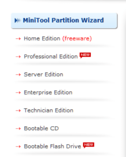

Hmm, my Wizards are different.
This page is for the several downloads available. If you download the Home Edition (freeware), then double-click on the exe file, you should have the page I mentioned. I downloaded my copy 3 days ago and got version 8.1.1
