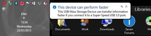

If your PC has USB2 ports, too, there's no problem.
USB3 devices are backwards compatible. You can test this simply by connecting your USB3 device to a USB2 port. You should get the usual warning about the device being able to perform faster if connected to USB3 port, but it works perfectly also on USB2 port. Just slower.
If you then need to boot to recovery options to restore an image stored on a USB3 drive and USB3 drivers / ports are not working, simply connect your external USB3 drive to a USB2 port. I have done this multiple times, restored an image from a USB3 drive.

So if I need to restore an image from the drive, I can plug it into a USB2 port (while the computer is off), turn on the computer and do a restore from the image. How long would this restore take if say the image is from a HDD with 100GB of data?
I'm going to look at the Marium website and see if you can use USB3. I don't think it will as the drive will only be recognized if Windows is running (with drivers installed).

It is impossible to say how long restoring an image takes. Using Windows native tools, I have done it sometimes in 15 minutes but I remember needing almost an hour last time restoring home server.
As I mentioned in my previous post you can easily check that your USB3 drive also works on USB2 port by connecting it to one.

My USB3 drive does work in a USB2 port but as you said it tells you that it will work faster if plugged into a USB3 port.
I did a little checking and I think Macrium reflect will work with USB3 but "additional drivers" are needed. I downloaded the free version, I'll see if I can create an image and also restore from the same image using the USB3 drive. I don't know if the free version supports additional drivers though.
