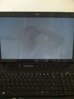

Ok will do, but I never actually got the BSOD. Maybe I was using the term crash in the wrong mannor. what I meant by crash is that the screen will go black or have vertical white stripes and no response from the computer in any other way. see the attached image

Can you plug in an external monitor (to most laptops) to see what appears?
If that works uninstall and reinstall your Display driver, check for an Update via optional Windows Updates and your model's Support Downloads webpage.

I'm guessing this is most likely your Display adapter, either its driver or the chip itself becoming loose or going bad. Someone else might have a different idea.
Try every driver available from Vista forward. Remember the drivers W In7 wants are delivered via optional Windows Updates when you enable Automatically get recommended drivers and updates for your hardware.
Try different screen resolutions and refresh rates.
Try running both with and without the driver software package checked in msconfig>Startup and >Services. The Catalyst bloatware can be a problem sometimes.
