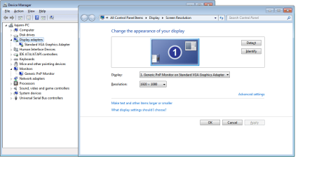

I just recently reinstalled my windows 7 OS because I wanted to move to 64 bit from 32 bit. While on the 32 bit OS I had two monitors one on the VGA and one on the HDMI. Both were working fine and had no problem. Now after I changed it to the 64 bit OS without changing anything else this is what is happening. The two monitors are detected both show the exact same thing as a duplicate. I want to extend, meaning that I don't want both monitors to show the exact same thing but extend the desktop. I right clicked and went to the Screen Resolution and it's only showing one Display, even if I press Detect nothing is happening.

Hey,
I have attached the device manager and system information.

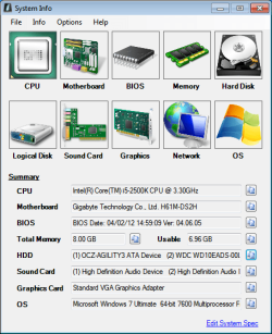

Here you go,
Thanks,

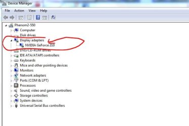

It is still showing standard VGA Adapter. Try running Windows Update in Control Panel to see if it finds the correct Video Card & the driver for it.
