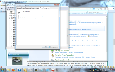

Have you tried going into the system folder in the control panel and then into device manager and looking under power management for each usb hub to see if the "allow windows/computer to turn this device off to save energy" or something like that box is checked? That may not be the exact wording; but; have you checked to see if that box is checked? Cause if it is; windows is probably turning power to the associated usb hub(s) off; which may be what in turn is causing the issue. Try checking that to see if that resolves the issue. Take a look at the image I have uploaded and it will show the box i am talking about.

Thanks for responding mate.
Currently all those checkboxes are unticked (although the power management options aren't there for USB Composite device or USB Mass storage device). I've variously tried them all and separately ticked and unticked too, to no avail.
