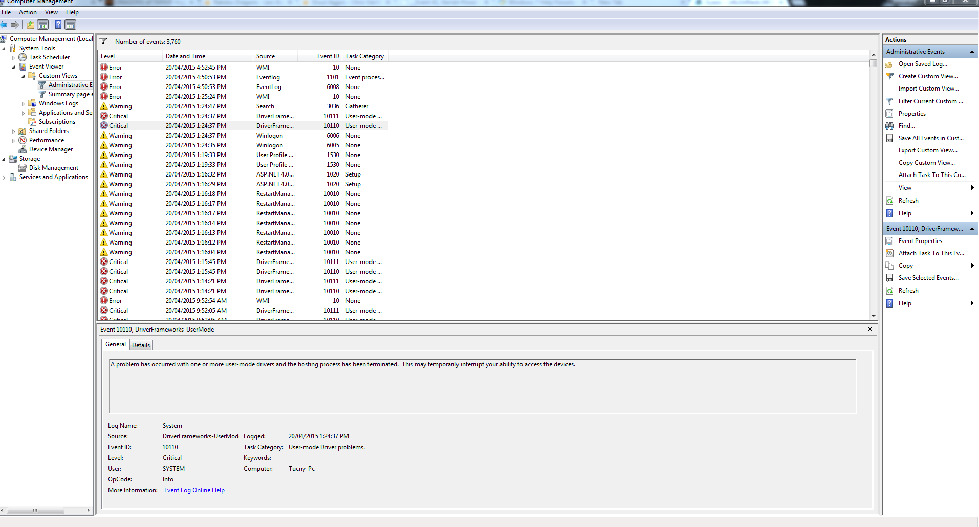

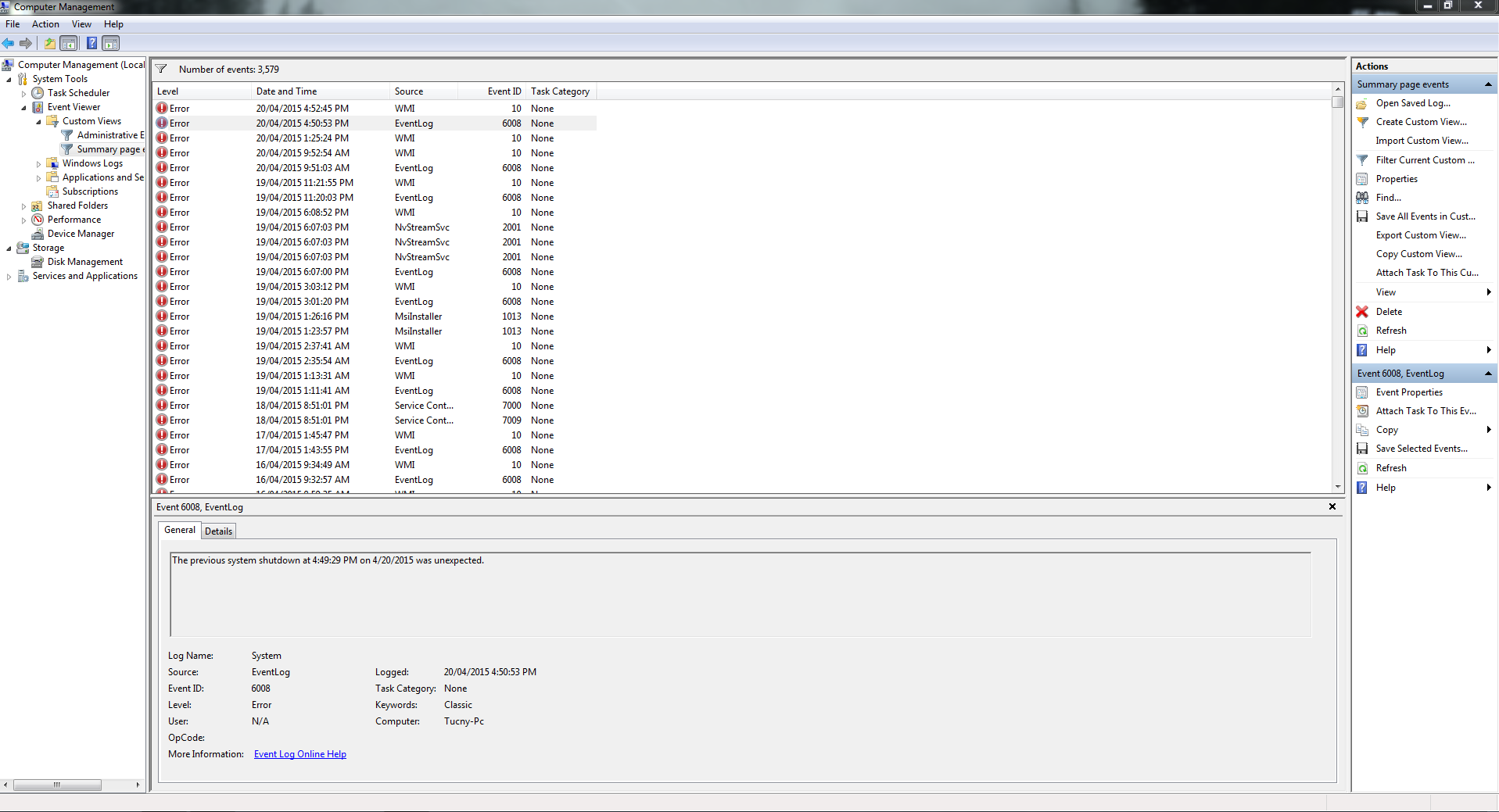

Hi, my computer randomly crashes at various moments. The screens just freeze but the computer keeps running. I have to hard reset every time it crashes. It used to happen very often but after removing drivers and updating them it's way less frequent. It still happens atleast once a day.
When I look at the even viewer I get these error at the moment of the crash, im not really sure what to do with these.
I searched a lot and didn't really find anything useful to fix the problem... Thank you for your time.

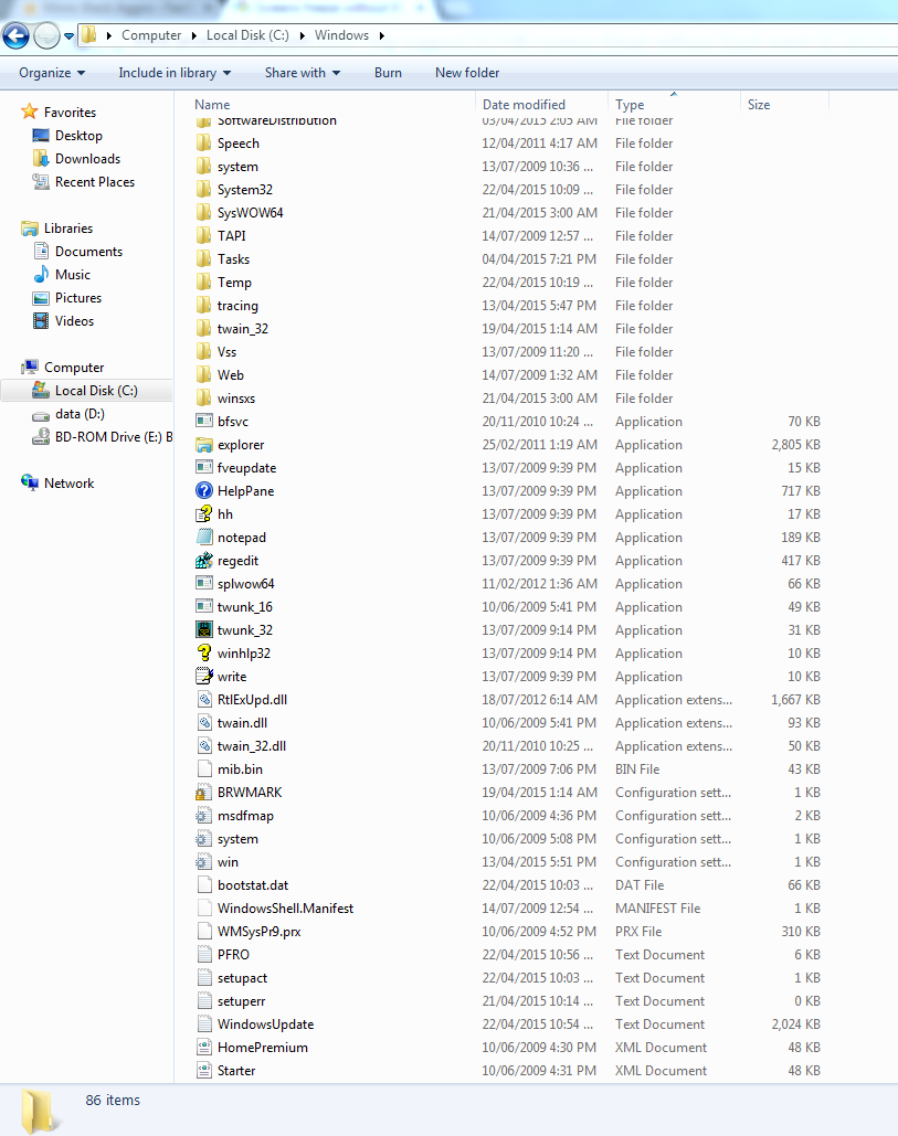

Its ok, I followed the right link for windows 7. My computer froze once again the same way it used to and it didn't create a minidump file. I dont see it in c:\windows

it crashed again. What is curious is that it reset my graphic settings in league of legends as if I never played.
It didn't create anything to record the crash in windows

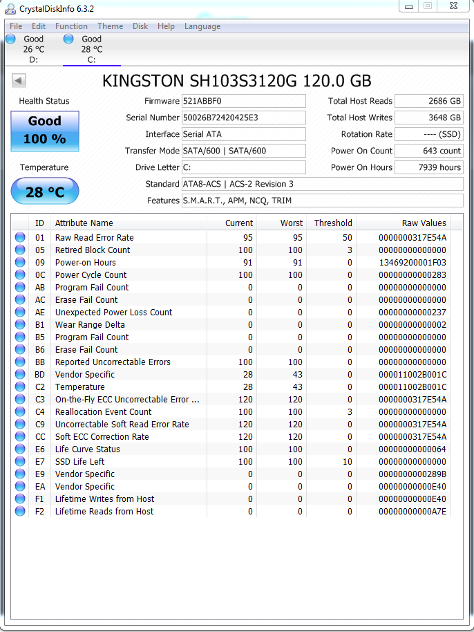

I can't seem to update my ssd, not too sure what the problem is there's not troubleshooting.

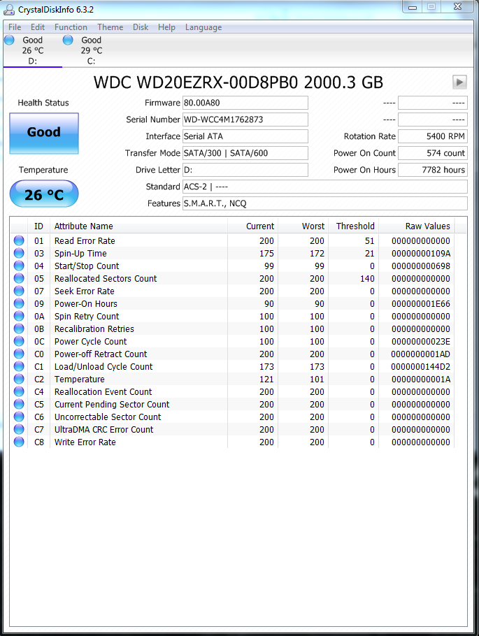

I tested my hdd with the extended test and it passed
What does it mean? Is there firmware update available and you cannot apply it?

Good news. :)
Now wait and observe how it goes. Let us know for any further issue.
