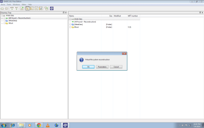

6. After saving the log, choose the first found file system and press "Open Volume" button. You will see folder structure like in the below picture.
7 Now double click on "All found + Reconstruction" and a confirmation window will appear. Press OK button and the reconstructed file system will be presented.
