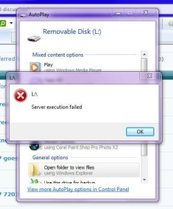

Does anybody know what is causing this error:
I restarted Prometheus this morning to allow some updates to be installed, and when I got home from work this afternoon, I get the message "Server Execution Failed" with anything that uses "explorer.exe" (Computer, Control Panel, Libraries, etc...).
My drive letter assignments for two of my drives have also become jumbled:
I is now D and D is now I (F, G, H and J are all still correctly assigned).
I used System Restore to reverse the updates, but that did not solve the problem. SFC /SCANNOW reports "Windows Resource Protection did not find any integrity violations."
And Murphy's Law states: "The split second you mention the problem to someone else, it goes away". As I was making this post, the "Server Execution Failed" error went away, and Explorer.exe started working normally again...
Go Figure...
